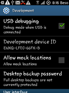

1-Install "USB Drivers"
2-Enable USB debugging...open setting >> developer options >> USB Debugging

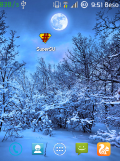

6-This should be the result
Now your phone is rooted
