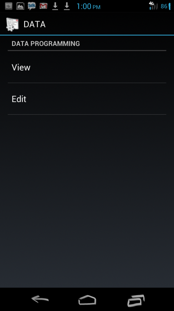

Use Dialer Codes
If you do not have a CM10 Rom you may enable LTE Only using dialer codes. The Dialer Code is
*#*#DATA*#*# (or *#*#3282*#*#).You will enter Data Programming.
Enter Edit Mode.
. You will need your MSL. To get your MSL you can use the MSL Script (Please leave -viperboy- some thanks.). Follow the Instructions in the MSL Script thread.
Once you have your MSL and are in Edit Mode do this.
Go to Others/More, (sometimes its in HDR/1X Selection) and Choose LTE only. (If you can't find it. Disable Data Connection and go to Advanced, scroll all the way down and you should see LTE Status. Enable this but make sure CDMA stays off.) Then Reboot.
(Note this method may not work for many people. Sorry :c)
