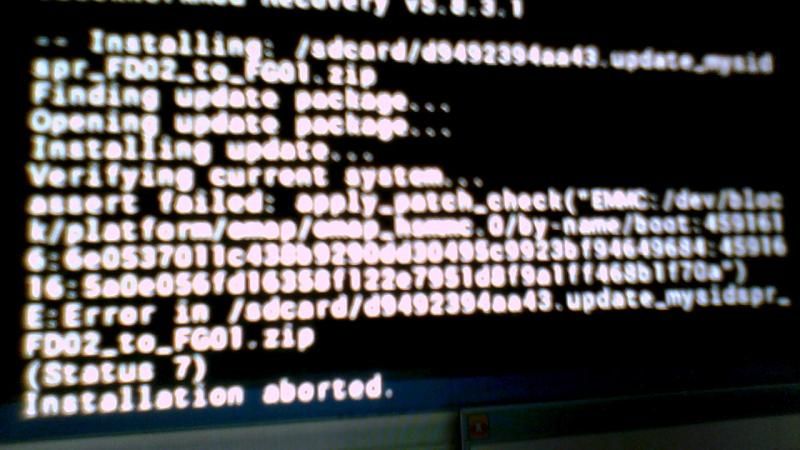

I am so so sorry for this but I can't figure out how to take a screenshot in recovery mode.
When I install the OTA update in CWM (flashed it back), this happens:
This is what happened last time with FD02, more or less.
You are getting that error because you are using a custom kernel. You need to be running the stock kernel for the build you are running.
Thank you so much. That's news to me. How do I shove a stock kernel into it?
Do you know how to use fastboot? If so, grab the boot.img file for whatever build you are currently running and flash it: fastboot flash boot boot.img
I'm not in front of a computer now, so I can really provide more details right now.
