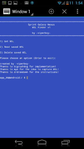

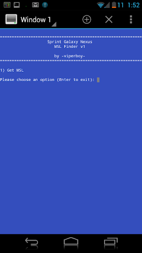

How do I use it?
  • Open Terminal Emulator, or similar (NOTE: You can do "adb shell" and run it from there as well)
  • Type "su" (lowercase, no quotes - approve Superuser request if prompted)
  • Type "msl" (lowercase, no quotes)
  • Follow the prompts

Q: Can I run the script without root?
A: No, because we are reading the logcat from the phone, we need root access. However, if you forget to type su before running, the script will attempt to run as root anyway.
Q: Why isn't the option for reading or deleting the MSL present?
A: The script knows if the file exists or not. If you don't see the options, a valid MSL has not been found
