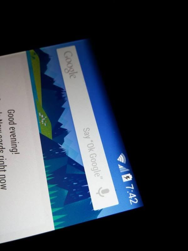

Hey Guys, I'm a New Nexus 5 user here..
Recently, there's this irritating bright spot on my screen.. at the top of the notification bar..
What's the cause of the problem and if there's any advice?
I can't RMA cause it bought it from another person

hi, not a variation in the back light but a stuck white pixel at the notification bar, i think it's called a hot pixel..

There are methods of trying to unstick stuck pixels. Mostly using apps and background colours...

You can absolutely fix stuck pixels by cycling colors on an LCD display. Dead pixels cannot be fixed.
http://en.wikipedia.org/wiki/Defecti...us_dead_pixels
I've personally fixed a stuck pixel via jScreenFix.
