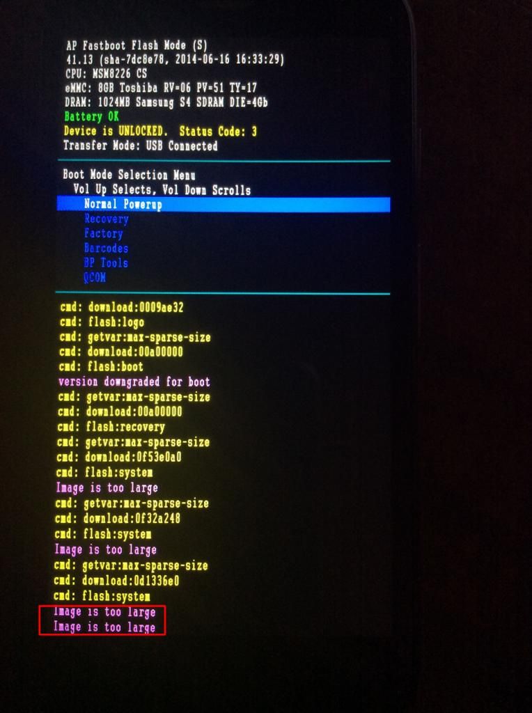

When I try to flash the ROM (non GPE), on this commands:
mfastboot flash partition gpt.bin
mfastboot flash motoboot motoboot.img
I get this error:
And during flashing system, I can read this:
Any suggestion?
When phone reboot, it stay at Motorola warning, and nothing more happen.
I get this error:
Any suggestion?
This is happening because you had 4.4.4 GPE, not 4.4.2. Now you must wait for a 4.4.4 image, is the only thing that can unbrick your phone.
