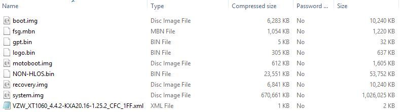

I just noticed the T-Mobile SBF thread and thought I'd poke around on the trusty old Moto X Firmware Page. Looks like there are quite a few carrier specific 4.4.2 firmwares available.
Moto X Firmware Page (All Carriers/Models)
From Android 4.4.2 - Blur_Version.164.55.2.ghost_verizon.Verizon.en.US:
XML Contents:
<?xml version="1.0"?>
<flashing>
  <header>
    <phone_model model="VZW_XT1060_CFC" />
    <software_version version="ghost_verizon-user 4.4.2 KXA20.16-1.25.2 2 release-keysMSM8960PRO_BP_2323.031.111.00R" />
    <interfaces>
      <interface name="AP" />
    </interfaces>
  </header>
  <steps interface="AP">
    <step operation="getvar" var="max-download-size" />
    <step operation="oem" var="fb_mode_set" />
    <step operation="flash" partition="partition" filename="gpt.bin" MD5="DA86065451752C9FAA4EE3AE41E91EE5" />
    <step operation="flash" partition="motoboot" filename="motoboot.img" MD5="32232CAE7CA8459BD52FB9FC9A0E57F6" />
    <step operation="flash" partition="logo" filename="logo.bin" MD5="5C8C2A8BA7F9E6F77DF5BEC5481A31A9" />
    <step operation="flash" partition="boot" filename="boot.img" MD5="B813274A74FF1278A41C19905E76768B" />
    <step operation="flash" partition="recovery" filename="recovery.img" MD5="9A3EA0D90080200826EE7B50164012BF" />
    <step operation="flash" partition="system" filename="system.img" MD5="CC3A59472E7A577759A7CCF617B74581" />
    <step operation="flash" partition="modem" filename="NON-HLOS.bin" MD5="1D4283E8D3B0EF528F2E4A1F67D9E04B" />
    <step operation="erase" partition="modemst1" />
    <step operation="erase" partition="modemst2" />
    <step operation="flash" partition="fsg" filename="fsg.mbn" MD5="EC92255E54062C65AE72A4926361429B" />
    <step operation="erase" partition="cache" />
    <step operation="erase" partition="userdata" />
    <step operation="erase" partition="customize" />
    <step operation="erase" partition="clogo" />
    <step operation="oem" var="config carrier vzw" />
    <step operation="oem" var="fb_mode_clear" />
  </steps>
</flashing>
