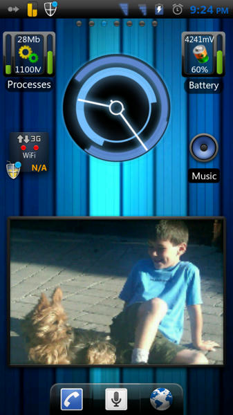

100% full is approximately 4200mV
As you can see in the cap below, it's showing only 60% at 4241mV (This was after booting up without the battery and putting the battery in)
A few minutes later, still plugged in, it showed 100% at 4225mV and then it went up to 4230mV.
Finally, I then unplugged the phone and I got a reading of 4196mV
