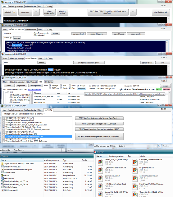

hiho,
i made an easy to use romcooking tool (i use it for moding my favorit roms )
its still alpha but if someone like to test it. ON YOUR OWN RISK !!!
because its written in C# and you can easyliy work with diffrent roms @ same time
just select an *nbf and this tool dumps it into a folder beside this file
i.e. no need for winhex(initflashfiles.dat) and default.rgu are save in the correct format automaticly
for simply add/remove files and/or regtweaks everthing is included
the scripts based on Molski's kitchen updated with bigstorage imagetools
the main app is the neokit.exe
have fun
inteks
you like it ? let me know ;-) --->>> DONATE

update version a020:
new pic preview with thumbs
on the fly UPX compresion
removing with contextmenu now to prevent removing by mistake / removed items are red
screen -> http://m8z.de/screen.a020.PNG

EDIT:
howto ->
1. select the *.nbf you like to work with
2. dump rom
3. if needed go to the default.rgu / user.rgu tab
3a. click create/load default.rgu
3b. make changes (if needed)
3c. click save
3d. if there are no errors !!!! click "copy to dump"
4. click load to load the initflashfiles.dat
4a. you can edit this file
4b. you can create lnk files from exe file in the dump dir
4c. you can create programs entrys automaticly like
i.e."Directory("\Windows\Start Menu"):-File("MediaPlayer.lnk","\Windows\PLAYER.lnk")"
4d click save (neokit removes the first 2 bytes no need for winhex)
5. removing files ->> neokit moves all selected file to the "removed" dir and move them back to dump if you deselect them ;-)
6. now click "build rom"
7. if there are no error click nb2nbf tool (create the nbf file in the neokit dir !!!)
7a. modelID -> Prophet
7b. outputfile should be -> ..\neokit\nk.nbf
7c. check File # 1: and browse to the newos.nb in the ROMDUMP dir
7d. Image Name -> select OS (Start address is filled automaticly)
7e. then click translate
8. click G3 or G4 !!! and then "start RUU" to flash the cooked rom . thats it.
