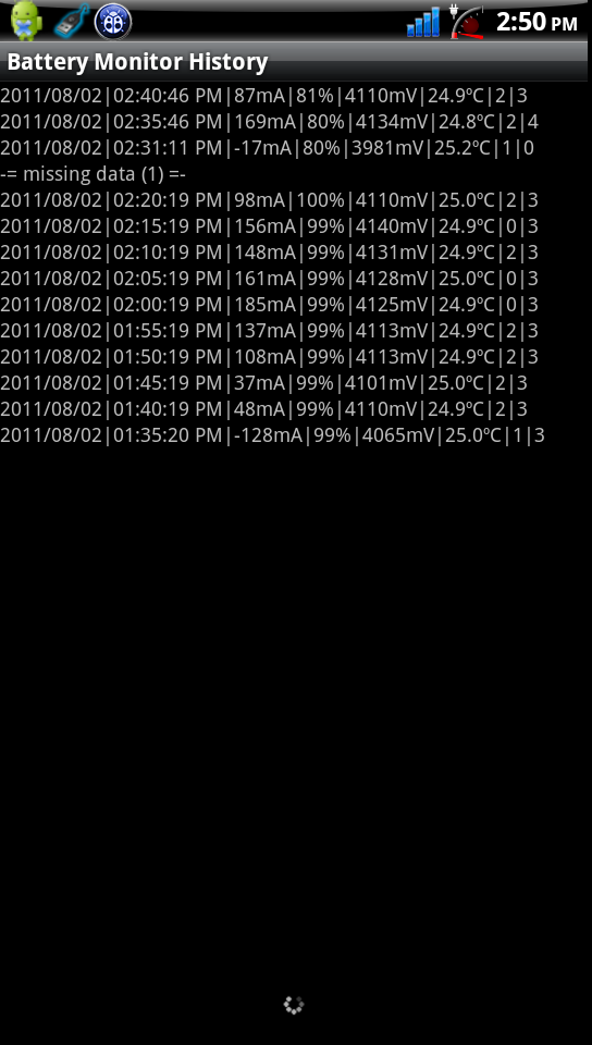

Hi Friends i have sensation rooted as we all did and since then following issues :
1. Offline charging (Fixed).
2. Now the fone charges offline but it says batt full at 99% and led turns green. Never touches 100% now. ever since flashed recovery. both old and new.
3. I can confirm this on anker 1900 mah batt.
4. can any one else confirm this also.

Yes, this is true.... The LED turns green on 99% and never touches 100%. But i did not care much about it as I was more interested in flashing ROMS...though this is a problem.... I have also ordered Anker Batt... waiting for the courier...

I noticed mine did this last night. I just kept it plugged in and it eventually hit 100%. I took about 9 hours for it to hit 100%. Hope its not like that every time. Ill be finding out tomorrow.

well it hit 100 even when the led was green

AFAIK Li-Ion batteries should never be charged to 100% because it shortens their life, most phones have a safety-mechanism to prevent overcharging.
Its intended to stop charging at 95% to 99%, but will almost always show that the battery is charged to 100% so the customer wont complain about it.
yes HTC is lieing to us, but for our own satisfaction.
So after we flashed the CWM recovery this "feature" is not there anymore and we can see the true charging state.
By plugging the power in and out over and over again to reach 100% you just damage your battery with those short charging cycles.
I read a interrestion thread about it in the Nexus S forums awhile ago and Wikipedia seems to confirm it.
I hope I could help you.
