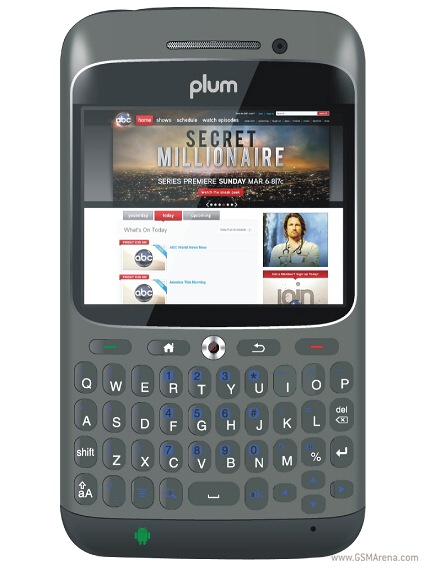

Dear All,
As the Name suggests it is regarding the China Android Qwerty Mobile A8.
It has various names of which are in the subject.
GSMAreana : Plum Velocity
Unofficial forum :
Official Site:
A8
Velocity
Manual:
User Manual
Here is my quick review of this peice.
The apps which were NOT supported by this cell were:
-> MoboPlayer
-> Poweramp
-> many video players & audio players were not supported.
The apps which worked:
-> handcent sms
-> launcher pro (any launcher thrown at it worked including metro UI)
-> Games (angry birds rio,librith, aliens invasion, etc)
-> Extended Controls
-> Updates from Market
Speed wise the fone is OKish as it has 200 MB of RAM out of which you get 100 MB free. By the time you keep using it 70 MB is all you have.
Froyo 2.2.1 works flawless in it.
Touch sceen is a bit bad as u need hard touch.
QWERTY works great but one big flaw...no "," in it.
Volume keys on the keypad itself.
2 music players inbut -- Music & 3D music player.
Dual cams work well
Fring gets installed but din try as no WIFI.
1200 Mah battery works gr8 for one or more days (Nokia BL-5K)
Dual sim support works gr8 aswell.
Very Light in weight but same time it is fragile.
Tones loud enough.
Still in testing phase will keep updated as I get more hands on experiance on it.
Btw it has 2 charging points 1 USB and 2nd Nokia point
it takes 3 hours to charge but holds good enough for long time
Need more info on this cell friends Kindly help me
