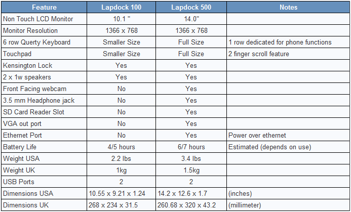

In the month that I've used the Lapdock 100, I've come across a few things that keep it from being a truly outstanding product.
First of all there are a few differences between the Lapdock 100 and the 500. (As shown below)
I'm planning on getting the 500 as well since I need it mostly for work to connect to an external monitor. But in the meantime these are my observations of problems in the Lapdock 100 I've encountered...
