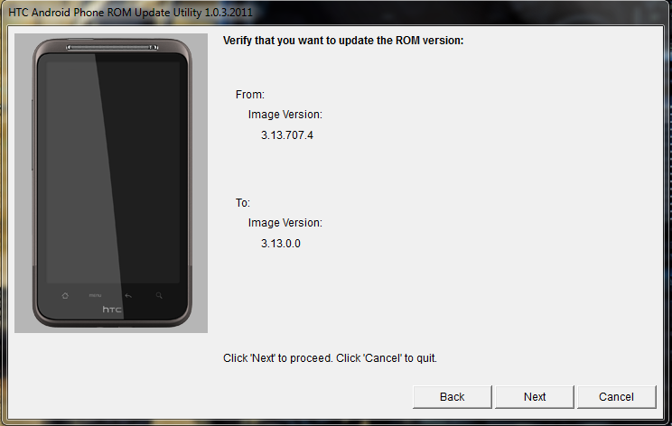

I wanted to unlock my DHD's bootloader and flash a custom rom on it with the S-On method which require me to manually flash the boot everytime i flash a rom.

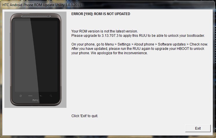

But i was unable to unlock my bootloader due to i was unable to get the identifier token from fastboot... I check on HTC dev website and it require me to upgrade my bootloader, yet again... failed!

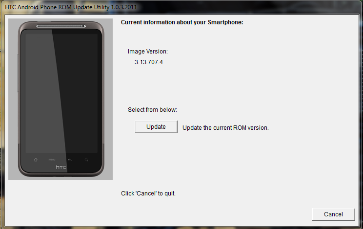

I also tried the bootloader unlocking tool and it automatically download PD9810000_Ace_Sense30_S_hboot_2.00.0029 RUU for me and the result also same as the one i downloaded from HTC dev
Here are some pictures:
I am on HBOOT version 2.00.0027, not sure if it was the latest though

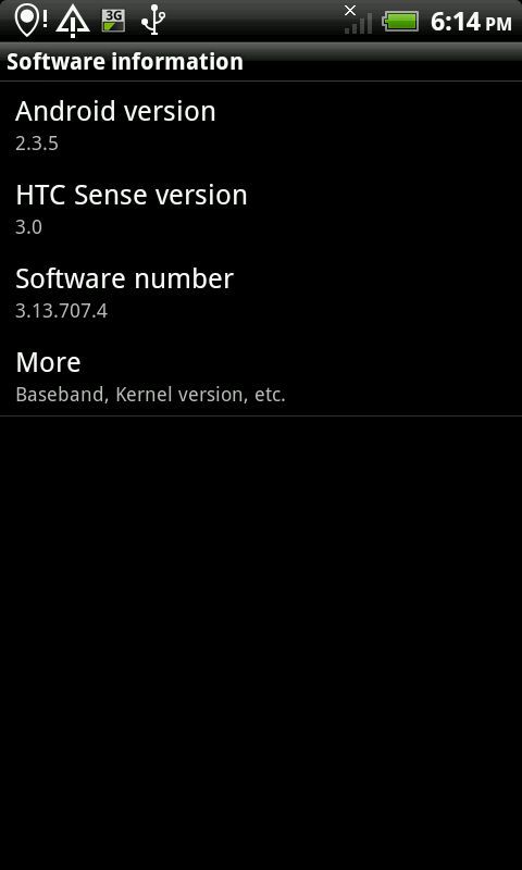

Currently i m using 3.13.707.4
As i know the previous owner did unlock and flash a custom rom on it before, and later he send it back to HTC service centre to flash it back to stock gingerbread
Any help / suggestions are appreciated and welcomed
Should download a RUU and reflash the phone?

did you already tried flashing it with different method...
you can read a guide in here..., this thread guide for htc sensation thread, but the guide is the same as for dhd too (but don't rename it like PG58IMG.zip for DHD..because this name code for sensation only, for DHD just rename it PD98IMG.zip)
just read guide especially at step 4.1 and 4.4, 4.4.1, 4.4.2
hope this help..and good luck..

Thanks for your reply bro... now should i flash the RUU which contains the full ROM or just with the HBOOT?

no..you don't needed flashing a full RUU...
just upgrade file firmware / hboot from the htc site that you're already download it..(this is will update it your hboot to version 2.00.0029)
you can try it in two way method..
1. flashing it PD98IMG.zip with fastboot method...
2. flashing it that loaded PD98IMG.zip file via bootloader from your sdcard..
