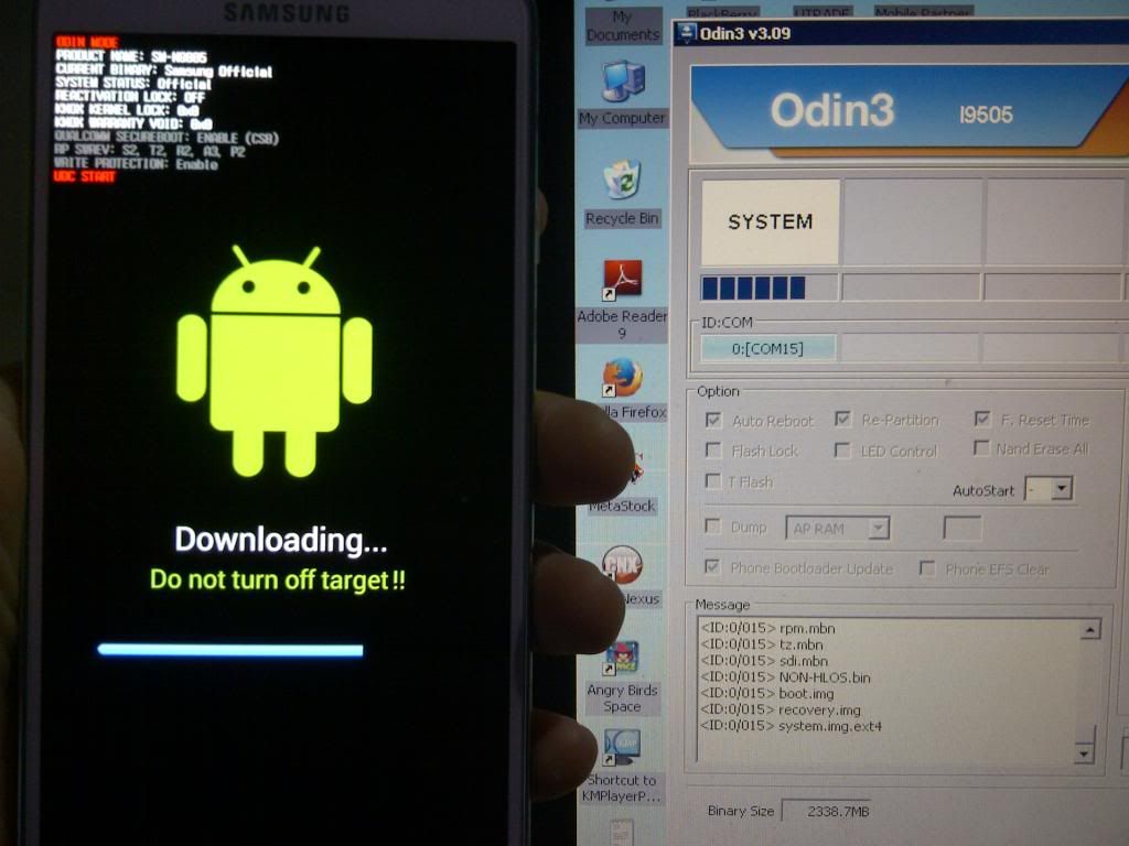

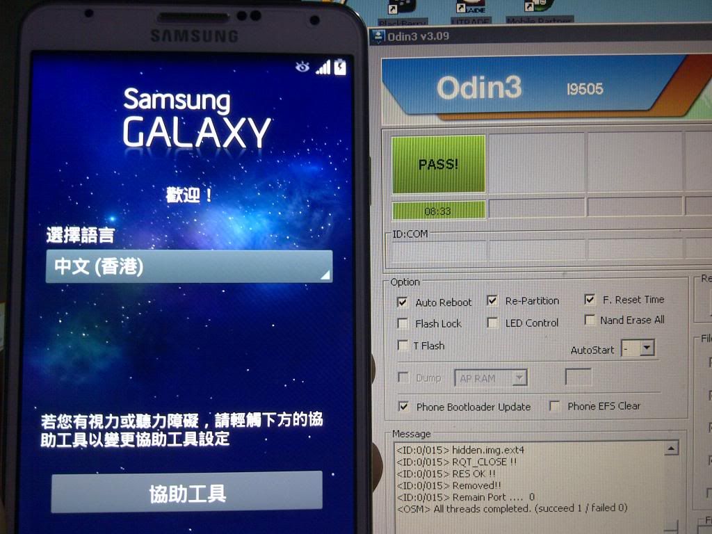

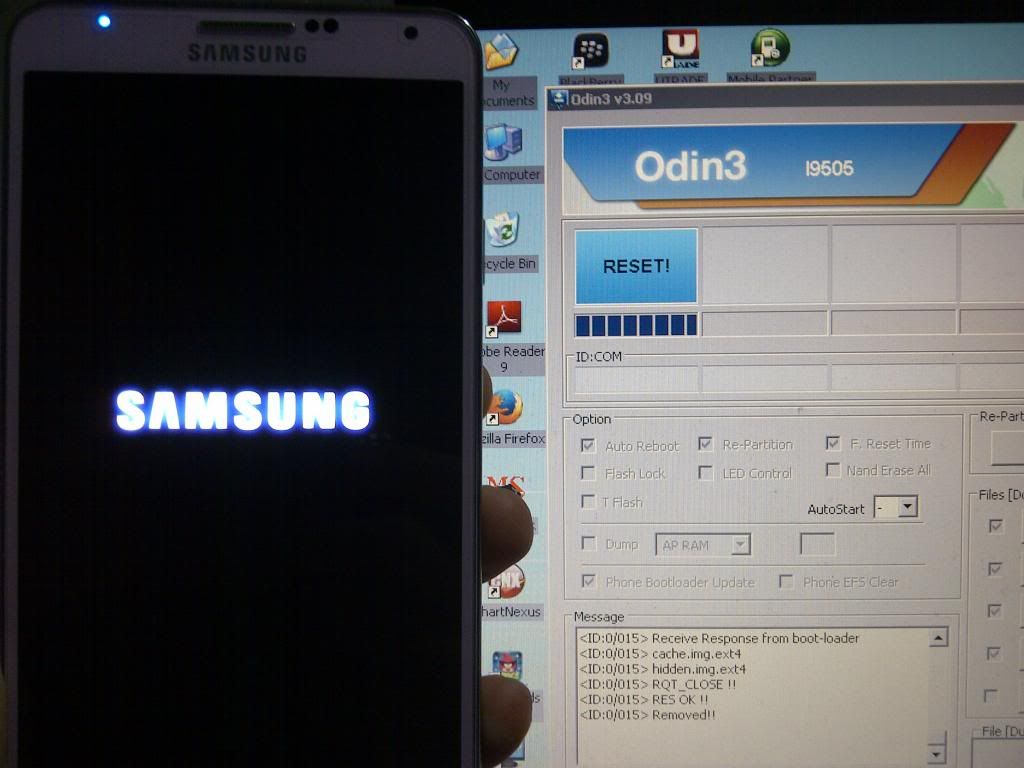

[successful] Note 3 Taiwan 16GB Survive UDC START problem
I have downloaded N9005ZHUENB1 and flashed to my Samsung note 3 Taiwan 16GB , succeed
I Survive
My Samsung Galaxy Note 3 Taiwan Region 16GB is UP and On Testing
my problem is odin mode with new line "UDC START"
hope this can help somebody

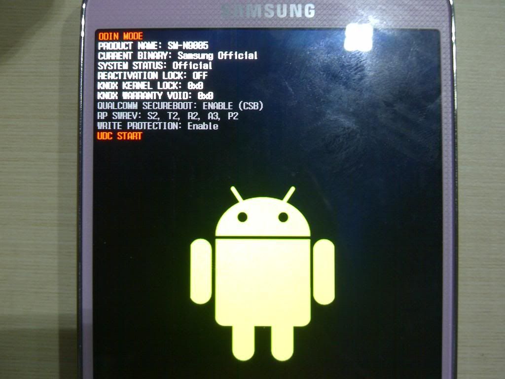

thanks very nice . i have note 3 softbrick
ODIN MODE
PRODUCT NAME: SM-N9005
CURRENT BINARY: Custon
SYSTEM STATUS: OFFICIAL
REACTIVACION LOCK: OFF
QUALCOMM SECURE BOOT: ENABLE CSB
AP SWREV: S2, T2, A2, A3, P2
WRITE PROTECCION: Enable
UDC START
succseed

UDC Start is not warranty voided. Why is everyone freaking out when they see a new sentence in bootloader? I have it, and it is because of the new 4.4.2 bootloader, stop freaking out everyone! :/
TL;DR, YOU DON'T NEED HELP, IT IS NOT A PROBLEM.
I Survive
Link
forum.xda-developers.com/showthread.php?t=2636699
Friend,
You have saved my life!
I thought I was good for some very bad holidays, but HAD TO FLASH KK, which broke my phone haha, you know what I mean.
Thanks again for giving me a phone that works
