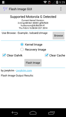

Description:
This android application, FlashImageGUI, is basically a GUI interface for the linux binary, flash_image provided by google in AOSP for loading custom kernels and recovery images onto the phone.
This app allows the flashing of kernels and custom recovery images in normal android mode!
Current Device Support:
Full Kernel (Anykernel and boot.img) Flashing and Recovery (zip file or image) flashing: Moto G, Nexus 5, Sprint Galaxy S4, International HTC One, T-Mobile HTC One, Sprint HTC One, HTC EVO 4G LTE, HTC One S, HTC EVO 3D CDMA and GSM, HTC One XL, HTC Droid DNA, HTC Amaze, HTC Vivid/Holiday, HTC EVO 4G, HTC EVO Shift, Google Nexus 4, Google Nexus 10, Google Nexus 7, Samsung Google Galaxy Nexus, Nexus S/Nexus S 4G & LG Optimus
Full Kernel, Logo and Recovery flashing: Samsung Moment, Transform, Intercept and Acclaim - the s3c6410 series of devices
Full Kernel (zImage) Flashing: Samsung Epic
Check application version for updates
Future Support:
Let me know if there are any issues. Feel free to post the encountered issue and a link to the exact file that was flashed. Thanks for the support!
Install Directions:
Install process is the same as any other .apk. Download to computer and adb push or mount sdcard on computer and copy over or download directly to the phone. Use any file manager, adb, connectbot/terminal emulator to install.
My preferred method, maybe a bit technical: ./adb install c:\downloads\FlashImageGUI.apk

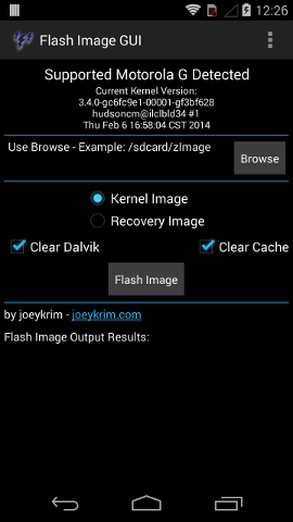

Screenshots:

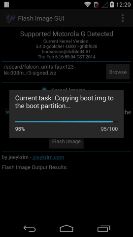

Users Guide for flashing ONLY a Kernel (zip file):
1) Ensure the bootloader is unlocked and root access is properly setup
2) Make sure the selected Kernel is compatible with the currently loaded ROM. If not, this will result in a lot of frustration!!! See troubleshooting steps below.
3) Download kernel zip file to /sdcard.
4) Open Flash Image GUI, browse and select kernel zip file, downloaded/loaded to sdcard in previous step.
5) Flash Image GUI will validate that the kernel zip file contains the minimum required files
6) Select the Flash Image button and Flash Image GUI will load the kernel and the kernel modules from the source kernel zip file.
7) Reboot
Troubleshooting after Rebooting:
First step, when experiencing issues flashing is to RE FLASH the files again. Many times, re flashing again will clear up any issues. If not, see the issues/solutions below.
Issue #1: If the device hangs or reboots while on the splash screen, the kernel itself or the ramdisk packaged in the kernel is NOT compatible with your device!!!
Solution for #1: Have to boot into fastboot (or directly into the custom recovery) and load the custom recovery to flash a known good kernel or restore a previously known good nandroid backup. Command: fastboot boot c:\downloads\cwm-recovery.img
Issue #2: If the device hangs or reboots while on the boot animation, the ROM is likely NOT compatible with the kernel!!!
Solution for #2: Have to boot into fastboot and load the custom recovery to flash a known good ROM/kernel combination either from a zip file or restore from a nandroid backup.
