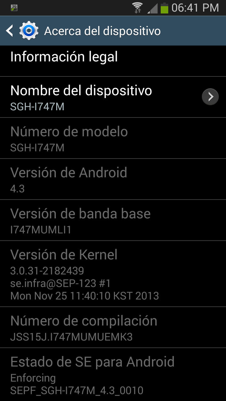

Previously had the intergalactic rom and 0 problems.
But now I can not flash any cr / modem.
Any idea why?

But when I flash a CR my wi-fi and data is not working. (tested in 3 roms)
And afther the first boot my phone dies an never boots again.
I need to iuse ODIN to fix it.
Looks like you have an hybrid firmware with the (stock) MUMUEMK3 Android 4.2 ROM and a MUMLI1 baseband/modem. The MUMUEMK3 is an official build of the 4.3. I'm not sure about the Mexican variant but I know that, with the US variant like AT&T, the stock 4.3 will not work with older modems and attempting to install an older modem always causes a baseband failure and consequent loss of all cellular functioning. I wouldn't be surprised if this is what you are experiencing and I would suggest you try to flash a 4.3 modem (MUMUEMK) instead. Or you may just look for a complete 4.3 stock image for your variant of the SGS3 and install this via custom recovery. I'd be surprised if this doesn't work.

Mmm actually I'm in the stock firmware.
But I can't find that modem (MUMUEMK)
http://forum.xda-developers.com/show....php?t=1831898
The problem here is If i flash a custom rom my phone only boot one time and then dies.
Even If I try to restore my backup (stock firmware) my phone never boot
Yeah I know is hard to belive (Tomorrow I record a video) but this is so confusing o.O

Looks like most of the emphasis is on the Canadian and US builds. Perhaps we sometimes overlook the Mexican and PR variants of the I747M. I believe, however, you may be able to find the stock image at Sammobile.com. I just checked there now and found this ...
http://www.sammobile.com/firmwares/3/?download=22509
I'll suggest you try to flash the complete stock image. With the 4.3 builds, Samsung appeared to have locked the modem tightly to the bootloader.
