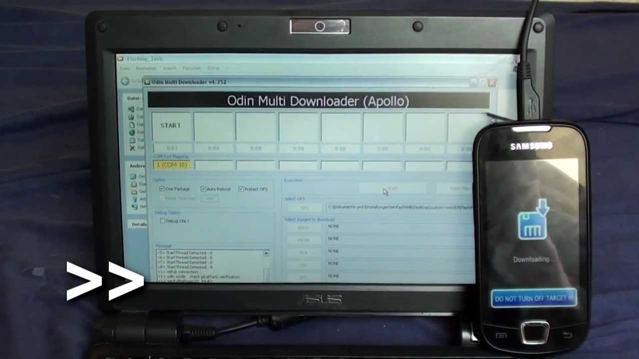

After Downloading the file ....... Extract it to any folder ..... and follow the steps Below :
  1. Double click < odin.exe >
  2. It will show dialogue < IMAGE PATH > Clock OK
  3. In the Middle left side Select < One package >
  4. Unselect < Reset Time ( Select ) >
  5. In the right Middle IN < Select OPS > select OPS
  6. Open apollo_0531.ops < In dialogue box >
  7. Select <OK> whenever the dialogue box < IMAGE PATH > appears
  8. In Right Down < Select Integrate Package - Check one package option > Click ONE PACKAGE
  9. In Dialogue Box OPEN < Any type of Custom ROM in ::: .tar ::: File >
  10. The odin Only supports .tar file
  11. Then Connect Your smartphone to PC in < Downloading MOD >
  12. There in COM Port Mapping < It appears >
  13. Check whether It says < Detected > in description
  14. Click on Start
  15. Then it starts to download < Custom ROM > IN your Mobile
  16. After Downloading .... It reboot's < Device > and starts Cyanogen (or) Any other MOD
CONGRAT'S YOU'VE FINSHED INSTALLING CUSTOM ROM
