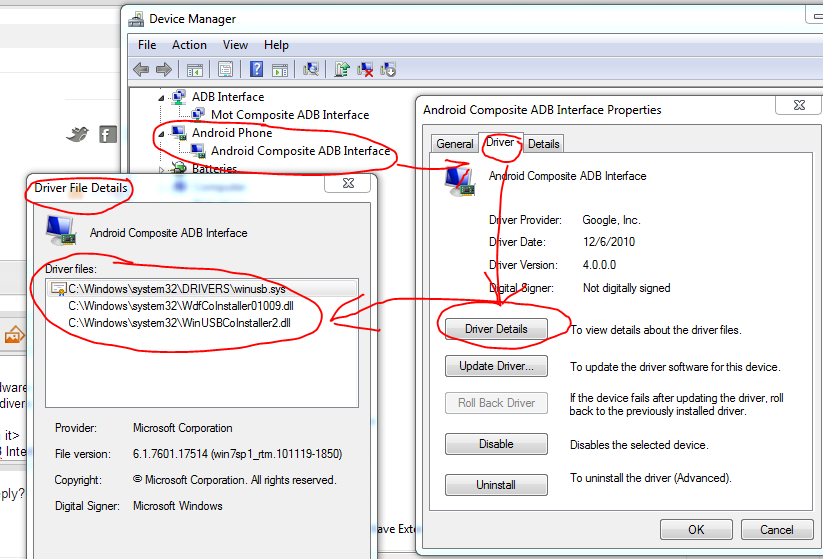

check specific drivers do they match this?

I think my issue was the computer not recognizing the device once it was in fastboot mode. I reinstalled the drivers (which I had done before), but this time they worked on the Windows 8 computer, so I was able to get TWRP and FFF on the device. I am working on getting CM11 on it currently. Thanks for all the help so far!
