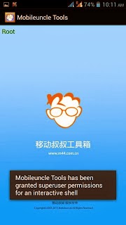

STEP 3: open app and select Super SU from dropdown menu, Select boromir now n reboot your phone.

STEP 7: Download Mobile Uncle tools from play store
Link Here

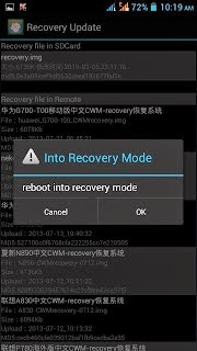

STEP 8 : Open Mobile Uncle tools and select Recovery Update (as in pic below)
STEP 9:Following Screen will pop up showing recovery.img, select recovery.img n select ok, then reboot into recovery n viola your phone is rooted n you flashed recovery too
CONGRATULATIONS!!! you have successfully rooted your XOLO Q800
