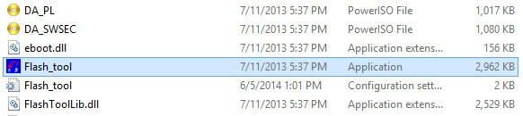

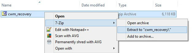

Extract the files to their respective folders
Now open the Flash_Tool.exe

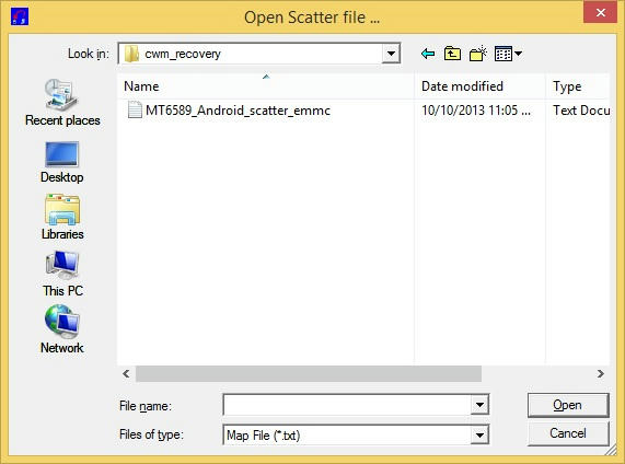

Open the scatter file from extracted folder

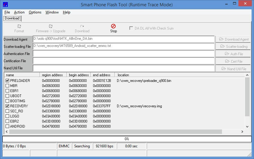

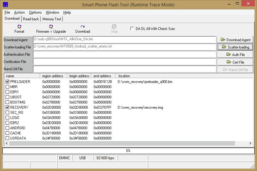

Make sure it looks like below. You can safely ignore the unticked ones

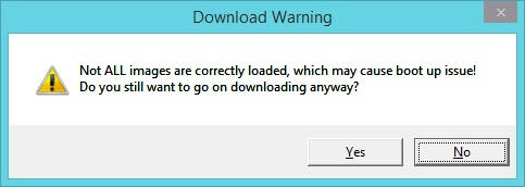

Click on Download
It will show you a warning, click Yes
Now the tool will wait for the phone to connect
