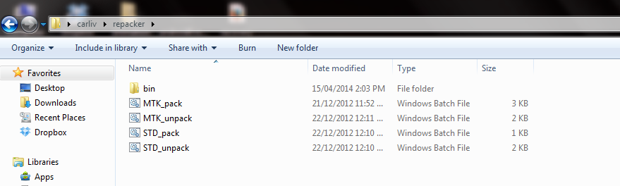

  • Just place the recovery.img in the same folder where You extracted The boot/recovery repack tool.

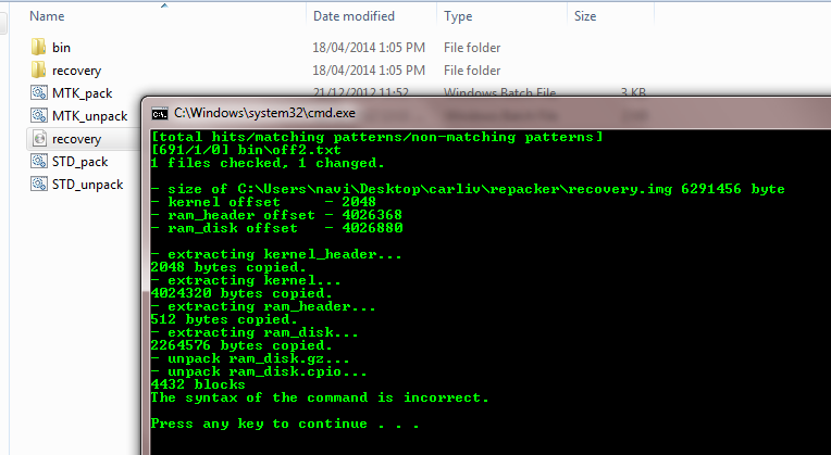

  • Drag and drop recovery.img on MTK_Unpack and it will split the recovery into its parts.

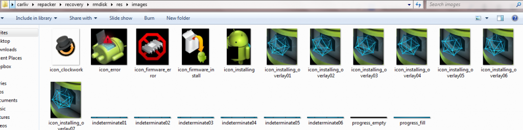

  • Now browser into recovery > rmdisk > res > images open the images edit them or replace them with your desirable .png's.

I dont know why ts not working for me. After re-packing, it gives a file "new-image.img" and not "recovery.img". And also reccovery folder gets a "new-image.img" automatically. If it is supposed to work like this. Even this I tried to flash it on my mobile (MI3), it loses CWM whole and goes directly into fastboot. Thanks it didnt brick my mobile but something is definitely odd when repacking.

bro see as per the repacking script it will create a new image u need to rename it to to recovery.img and more over the image that u are using in it that is to be edited in Gimp ... other i haven't used personally... and try to flash it using flashify.
post ur results too.

Sure, I renamed the "new-image.img" as recovery.img and put it back into old Cwm.zip And got the fastboot. Lost recovery completely two times. Thanks for reply though.
