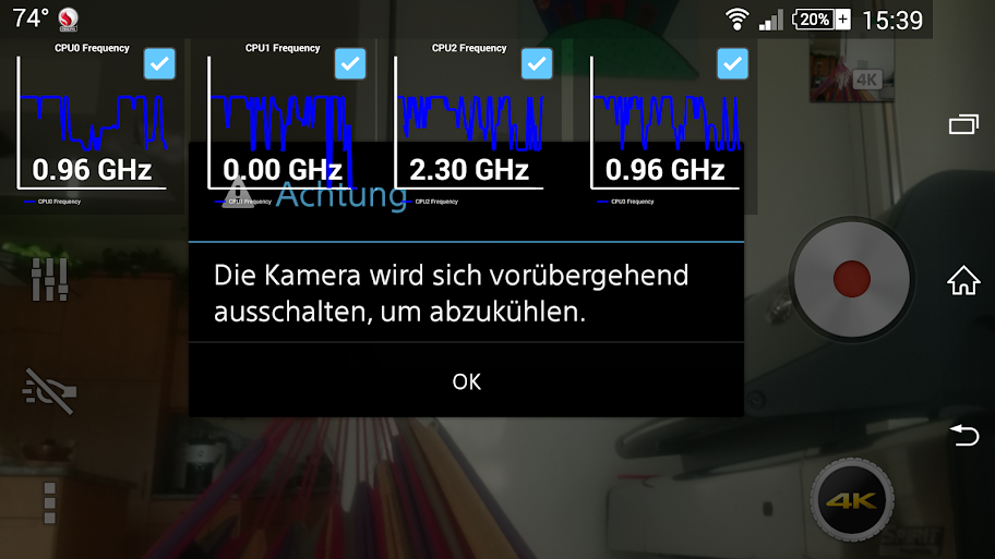

Using Ultimate Pure XZ2 v1.1 based on 413 ROM I get about 1 minute 4k recording and no throttling ^^
*Screenshots of camera are 1.8mb png files and not 180kbyt like normal ones -.- can't upload them direct will edit later*
Edit:
Start:
30Sec:
1 Minute:

http://forum.xda-developers.com/show...9&postcount=22
Camera quality is not effected at all by your bootloader status
Tested and proven, the same goes for 4k, quality is the same weather LB or UB
4K recording time is only increased by a few seconds when you undervolt, atleast from my experiance, this may varie per device due to AVS
