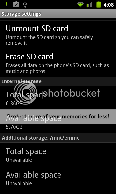

The only downside for this is that it uses the entire 6.5Gb of internal storage that the incredible has. The reason it does is because the emmc which includes the 6.5GB of internal storage also includes the 750mb's for the data partition and the 200mb's for the cache partition of the phone. For this reason HTC has locked this from being repartitioned. I did not find a way to unlock it although there probably is. I personally don't use the internal storage on my phone at all since most apps defaut to sdcard. If you don't use or need to use your internal storage this is a great alternative to what you can use it for. I tested many methods which included putting the rom on SD card or rearanging the partitions where the normal rom is stored and I found this method to be most stable and the least intrusive to your normal rom.

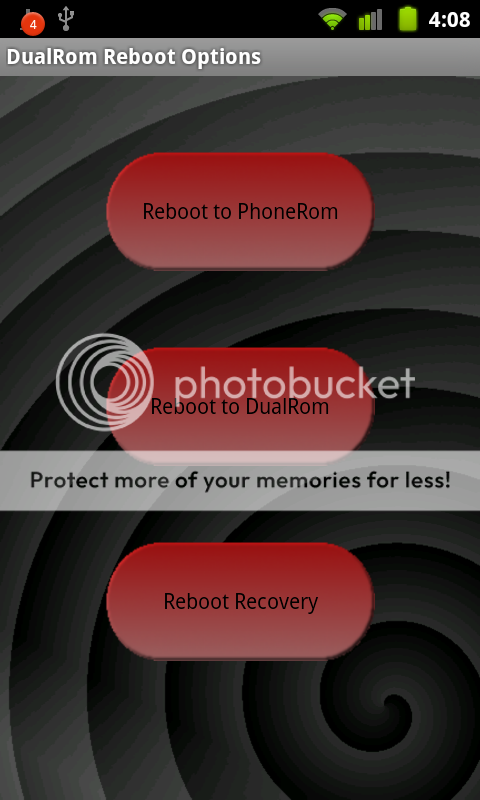

DualRom should work with any rom you use. For the DR Reboot app to work you will need a rom with busybox installed but that is pretty standard. If DR Reboot does not work for you you can use recovery to boot back and forth. The zip you flash in recovery only takes a few seconds so this is still a much faster option then doing nandroid/restore's.

1DRPrep-setupEMMCforRomFlash.zip We flash this zip first. All it does is change the filesystem of the internal storage partition(6.5gb) from fat32 to ext3. THIS WILL ERASE ALL FILES FROM YOUR INTERNAL STORAGE. Please backup any files you want to keep. This zip can also be used to reformat if you decide you want to switch from one version of DualRom to another(i.e. Sense to CM7). This zip will take a few minutes to flash so be patient.(I know my progress bars don't move right in recovery but it is working).
2SetupPhoneRomForDualBoot.zip We flash this second. This zip will do a couple of things. It installs the app into your current rom that will allow you to boot back and forth. It also backups the boot.img from your current rom to your sdcard so that it can use it when you want to boot back to the Phone Rom. It add's another zip to sdcard that allows you to boot back to Phone Rom from recovery. It also adds an edited vold.fstab to your current rom so that your phone will not complain that it can no longer fine the interal storage since your using it for something else. If you have dualrom already installed and decide to flash another normal rom to your phone you can just re-run this zip after flashing the normal rom.
