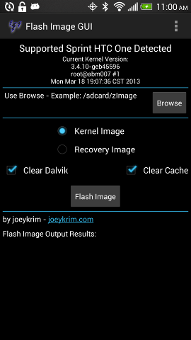

Description:
This android application, FlashImageGUI, is basically a GUI interface for the linux binary, flash_image provided by google in AOSP for loading custom kernels and recovery images onto the phone. No recovery or adb needed! Flash a custom kernel, boot logo (some devices) and custom recovery all from android w/o rebooting into recovery mode!
The application displays current kernel version information!
Current Device Support:
Full Kernel (Anykernel and boot.img) Flashing and Recovery (zip file or image) flashing: Sprint Galaxy S4, International HTC One, T-Mobile HTC One, Sprint HTC One, HTC EVO 4G LTE, HTC One S, HTC EVO 3D CDMA and GSM, HTC One XL, HTC Droid DNA, HTC Amaze, HTC Vivid/Holiday, HTC EVO 4G, HTC EVO Shift, Google Nexus 4, Google Nexus 10, Google Nexus 7, Samsung Google Galaxy Nexus, Nexus S/Nexus S 4G & LG Optimus
Full Kernel, Logo and Recovery flashing: Samsung Moment, Transform, Intercept and Acclaim - the s3c6410 series of devices
Full Kernel (zImage) Flashing: Samsung Epic

Users Guide for flashing ONLY a Kernel (zip file):
1) Ensure the bootloader is unlocked and root access is properly setup
2) Make sure the selected Kernel is compatible with the currently loaded ROM. If not, this will result in a lot of frustration!!! See troubleshooting steps below.
3) Download kernel zip file to /sdcard.
4) Open Flash Image GUI, browse and select kernel zip file, downloaded/loaded to sdcard in previous step.
5) Flash Image GUI will validate the kernel zip file is contains the minimum required files
6) Select the Flash Image button and Flash Image GUI will load the kernel and the kernel modules from the source kernel zip file.
7) Reboot
Troubleshooting after Rebooting:
First step, when experiencing issues flashing is to RE FLASH the files again. Many times, re flashing again will clear up any issues. If not, see the issues/solutions below.
Issue #1: If the device hangs or reboots while on the splash screen, the kernel itself or the ramdisk packaged in the kernel is NOT compatible with your device!!!
Solution for #1: Have to boot into fastboot (or directly into the custom recovery) and load the custom recovery to flash a known good kernel or restore a previously known good nandroid backup. Command: fastboot boot c:\downloads\cwm-recovery.img
Issue #2: If the device hangs or reboots while on the boot animation, the ROM is likely NOT compatible with the kernel!!!
Solution for #2: Have to boot into fastboot and load the custom recovery to flash a known good ROM/kernel combination either from a zip file or restore from a nandroid backup.
