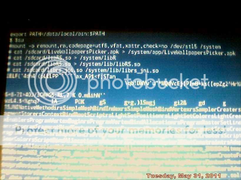

:: Enabling Live Wallpapers ::
1. After rooting your device, your good to go.
2. Install Busybox Installer.
3. Open Busybox Installer, OK, SuperUser request Allow.
4. If BusyBox is not found, tap Install.
5. Press Back Button on your tablet.
6. Install Terminal Emulator.
7. Open Terminal Emulator.
8. Type this commands.
su
mount -o remount,rw,codepage=utf8,vfat,xattr,check=no /dev/stl5 /system
cat /sdcard/LiveWallpapersPicker.apk > /system/app/LiveWallpapersPicker.apk
cat /sdcard/libRS.so > /system/lib/libRS.so
cat /sdcard/librs_jni.so > /system/lib/librs_jni.so
sample pic of my terminal emulator, I made a mistake in line 5 but it's ok just retype it.

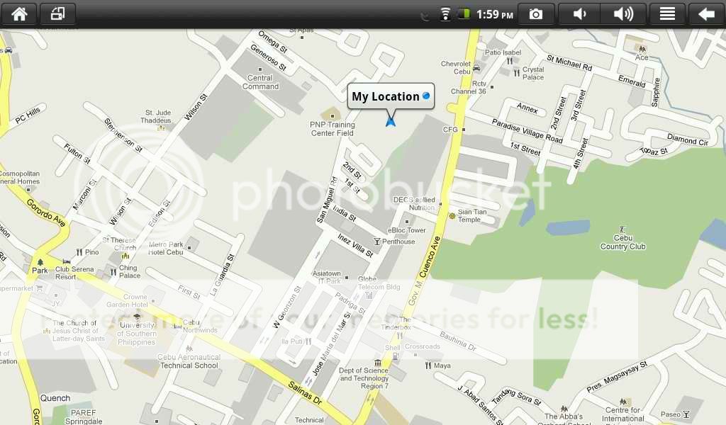

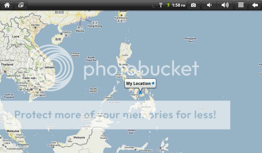

:: GPS Configuration and Setup ::
Download GPS Test Tool
1. Install that app in your tablet.
2. Go to Settings
3. Go to Location & Security
4. Check Use wireless networks
5. Check GPS Satellites
6. Plug your GPS Antenna.
7. Take your antenna outdoor, if the wire is still long try to place the antenna higher.
8. Connect to your WiFi.
9. Run the GPS Status application.
10. Wait for 5~20 mins for satellite discovering and locking.
11. Wait for 5 satellite lock on and you are done.
12. Run your Google Maps, and your locked to your location.
This is the picture number of satellites and number of locked satellites.
The GPS is very accurate.
