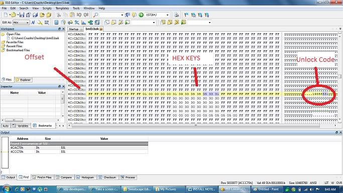

7. If you look at your Hex editor there are 3 window panes on the selected line (See Image Below)
e.g 4CCC60h <-- Offset
01 01 01 01 < -- Hex Keys
yyyyyyyyy <- ASCII text where your code is
8. Go through each result from the above search and you will see on the 3rd window pane (as shown on pic above) after the hex keys there is an 8 DIGIT CODE (Write this code Down) this is your unlock code NCK for your phone
Sidenote: SCAN THROUGH EACH RESULT AND YOU WILL SEE THAT IN YOUR RESULTS SOME OF YOU MAY GET UP TO 3 DIFFERENT 8 DIGIT CODES WRITE THEM ALL DOWN NORMALLY THE 8 DIGIT CODE THAT APPEARS THE MOST WILL BE THE ONE THAT UNLOCKS YOUR PHONE THE OTHER CODES MAY BE YOUR FREEZE CODE BUT I HAVE NOT TESTED THIS YET THIS 8 DIG CODE SHOULD SHOW ON AT-LEAST ONE MORE RESULT CHECK ALL YOUR RESULTS FROM THE SEARCH ABOVE( SOME OF YOU WILL HAVE YOUR CODE SHOWN AT-LEAST 2 TIMES AND SOME OF YOU WILL HAVE THE CODE SHOW MORE THAN 4 TIMES) YOUR RESULTS MAY VARY EVEN UP TO 39 RESULTS AGAIN SCAN THROUGH ALL RESULTS
