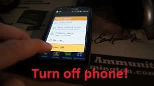

6. Turn OFF your phone

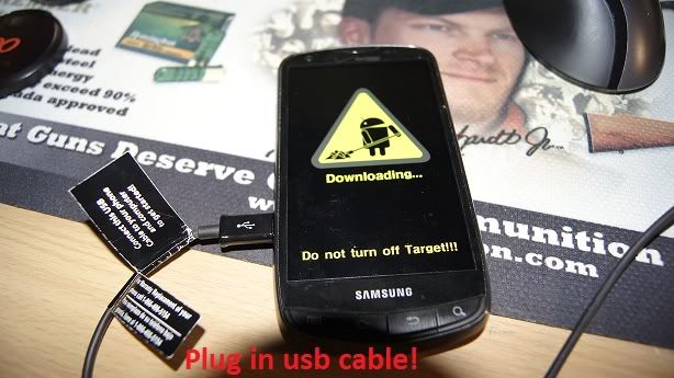

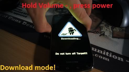

7. Now put your phone in download mode
Hold the "Volume down" key and plug phone into usb.
Alternative: Hold Volume Down and press power.
HINT: if that is a no go, take out the battery. While holding volume down, plug your usb cable in. Download mode should appear. Put battery back in.
8. Connected to computer via a good OEM usb cable if you haven't done so already. (it is recommended to use the usb at the back of your computer, If flash fails switch to a different one and try again)

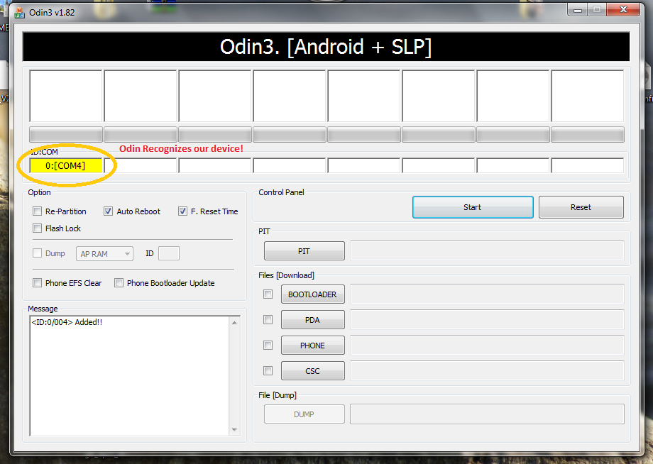

9. Notice Odin will pick up the device.

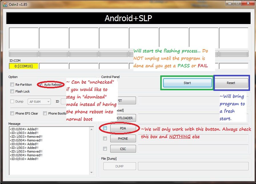

First bottom white slot should now be yellow with a "[COMx] x~ notates any number can be here

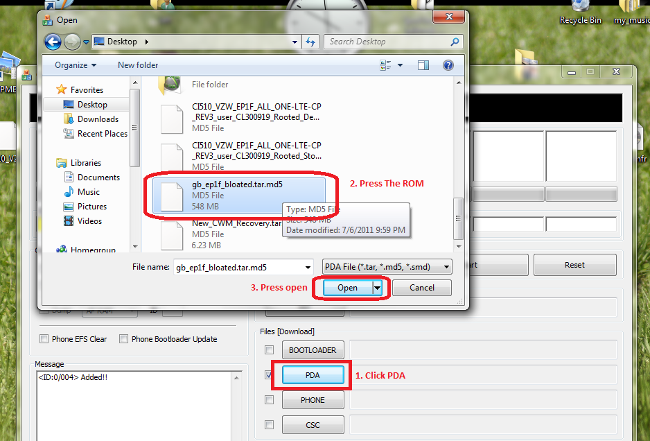

10. IMPORTANT: Check PDA and only PDA (under Files [Download])
11. Click PDA button
12. Browse to where your "Recovery MD5" ~you should have downloaded this in the beginning of the post.
13. Double check that you only selected PDA
14. Triple check you only checked PDA
Re-Partition--- Unchecked
Flash Lock--- Unchecked
Auto Reboot--- Checked if you would like your charge to reboot after the flash
F. Reset Time--- Checked
phone EFS Clear--- Unchecked
Phone Bootloader Update--- Unchecked
BOOTLOADER--- Unchecked
PDA--- Checked
Phone--- Unchecked
CSC--- Unchecked

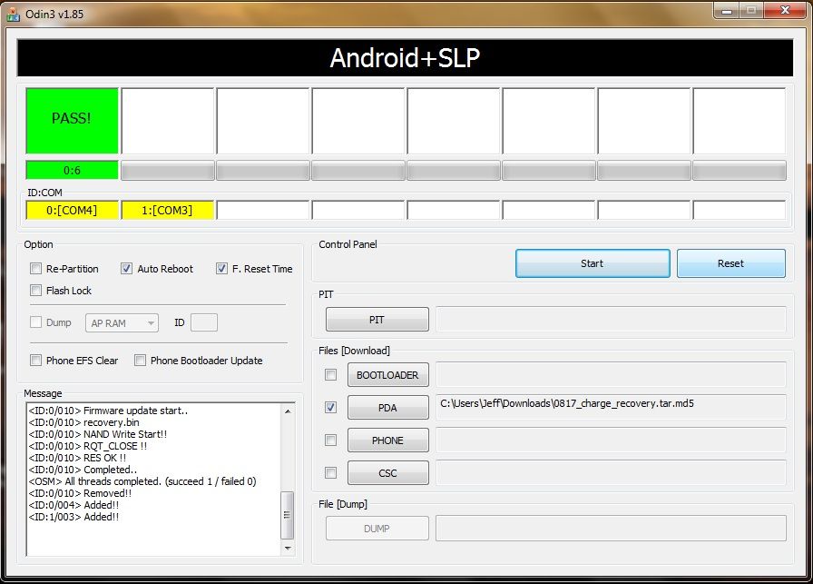

15. Now click Start button
16. WAIT
17. yellow bar should go green and a message should display on the page saying it Passed
18. If flash "FAILED" don't fret. Try it again. play around with flashing with and flashing without the battery in. If continues to fail re-download the Recovery and try again.
19. Custom "Recovery" now installed on device
20. Reboot phone if it hasn't done so already

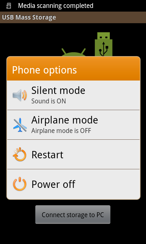

3. While device is on, Connect usb to computer
4. On your Droid Charge, Press "Connect storage to PC" button

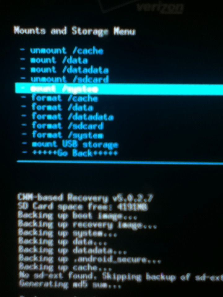

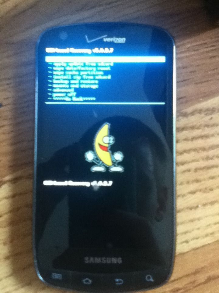

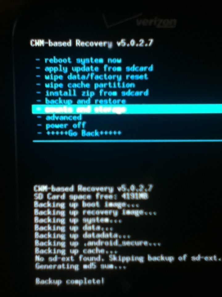

9. Now reboot into CWM Recovery on your phone
To boot into Recovery- Hold: Power+ Volume up+ Home buttons when phone is "OFF" until samsung is displayed. Boot should then take you to CWM should be a cyan colored menu screen.
10.Navigate to "Mounts and Storage". (using the volume buttons and power to select)
11. Select mount /System (it will change to /unmount when properly mounted)
12.Select mount /Data (I do this just in case)
13. Select +++++Go Back+++++
14. Select "Install zip from sdcard
15. Find you Rom or the Su Binary zip, select it
16. Select Install
17. WAIT until flash finished

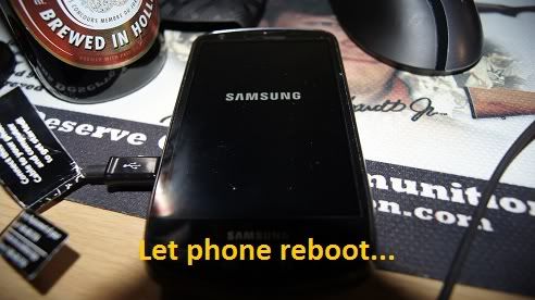

18. select "reboot system now"
19. Let system reboot (will take longer than normal on first boot)

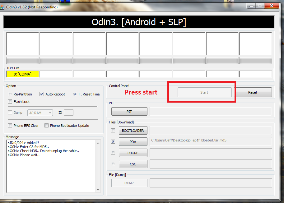

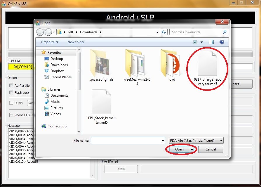

12. Browse to where your Rom is located ~you should have downloaded this in the beginning of the post.
PDA--- Checked
Phone--- Unchecked
CSC--- Unchecked
16. WAIT
19. Custom Rom should now installed on device

Scary..great explanation...the only thing I will add is to go into download mode...you do not have to press the power button....if you hold down the volume down button...it will go into download mode.......
oo hey your right. well you need to tap power if it is off
