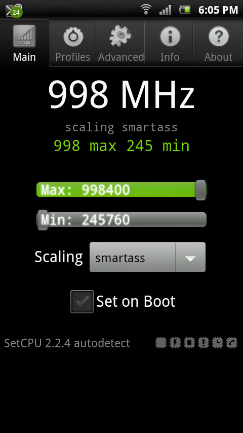

You can confirm that installation works either by SetCPU (it will report scaling "smartass") or by executing the following command:
cat /sys/devices/system/cpu/cpu0/cpufreq/scaling_governor

As far as I can see, when it goes to deep sleep, it stays there, if you minimally use the phone, it should last a long time. But once you turn on the phone, it will kick into high gear (998Mhz) very fast, to allow for fast response - and won't use any other intermediate frequencies.
