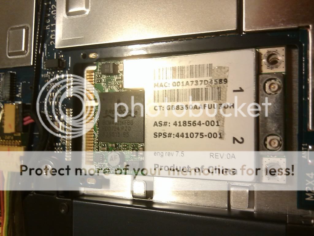

I'm looking to start a thread about turning an a500 into a a501. I've done a teardown of the a500 and it has the capability of potentially being able to support an internal card. It has the space/slot and screw mounts.
Before I start ordering and soldering parts to the circuit board I'd like to get a few facts straight.

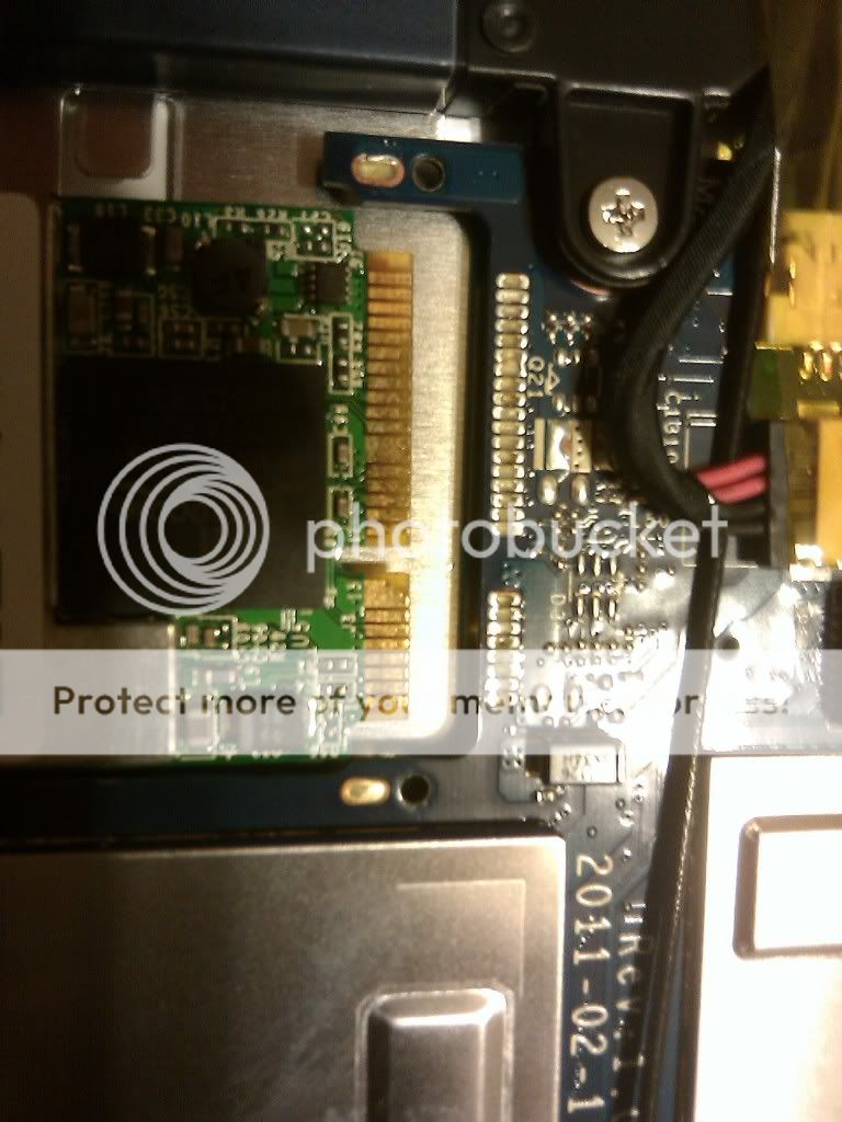

3. PCIe Riser extender - As you can see from these pictures, the plastic bracket is missing/not included. You can see on each side there is two holes for mounting the bracket. I'd recommend the extended below, as it will allow me the needed length between the two.

Here is the empty space:
Now here is the space with a pcie wlan card
You can see from the last picture that there is a space issue that needs to be addressed.
I would need to use riser with an extended back end inorder to align up this the screw mounts.
this picture is just of the screw mounts.

It looks like its missing one of these..
Mouser is a great source for parts like this. It will involve soldering a connector and possibly writing a driver.
Once you find out the parts requirement, any electronics repair shop can handle it.
http://www.mouser.com/Interconnects/...ors/_/N-72bz7/
I can't help anymore then this, I don't own one of these devices. However, kernel=drivers. You've got two issues. Kernel support and Hardware. Once you've got the physical connection done, search for some linux devices which uses similar hardware and grab the kernel modules built for your kernel. If you're lucky, you can just insmod them into the device. If you're not lucky, you'll need to build from source.
