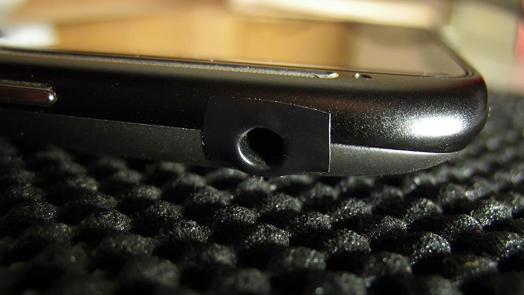

Here is another simple fix for another HTC's "design flaw". If you have your music playback cutting out, or songs skipping back and forth and pausing randomly (all while on headphones), this fix is for you. If you don't, you probably will at some point...
It seems there is a reason why Nokia puts an ugly piece of plastic around the headphone jack. Can you find that on your phone? No? Well, there's your problem!
In Sensation's case, headphones constantly "touch" the back cover, which eventually scratches out the paint, revealing a tiny bit of bare metal. Similar thing happens on (unconfirmed): HTC HD2, HTC Desire HD (reported but unlikely), HTC EVO 3D, Samsung Captivate, Motorola Droid X and possibly a few more phones. Some of these have a silver ring around the jack, but this obviously doesn't help.
So, here it is on the Sensation:
Problems occur once headphones come in contact with bare metal. I tried covering the scratch with paint, nail polish and super glue. None of this works, it just removes more paint. Coating it with more permanent paint would probably work for a while, but that would peel off eventually.
From what I can see, there are two ways to fix this.
One is quite simple:
While two involves modifying the headphones themselves.
It took me a while, but I found a perfect solution:
These are... dental.. rubbers... I actually have no idea what they are really called They are used for braces. I believe you can find them in any dental store. Just bring this picture with you They are under 1$, and come in various colours.
This is what you need to do with them:
Basically invisible
Here is another way to do the same thing, done by Mr. Ulmo.
In case this happens on your phone (non-Sensation) and you are able to fix it, please notify me so I can add it here
Also, in case you don't want to do any "hardware alterations", this app blocks headphone buttons, which kind of fixes the problem.
Hope I helped!

14th October 2011, 11:45 AM |#6
zmfl's Avatar
Thanks Meter: 208
I solved it... It took less than expected
I opened the phone up, thinking I'll have to mess with the jack, but the jack is fine.
It's due to the worst back cover in the universe (again). EVO 3D for example has a nice finish around the jack, so headphones don't touch the cover. Sensation on the other hand has nothing. Once paint peels off that nothing, headphones start touching bare metal, and go crazy.
Fu**ing flagship device...
I think I'll fix it with black nail polish, or silicone, or something...
