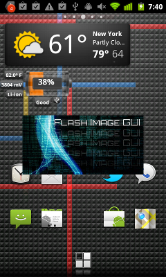

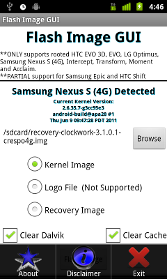

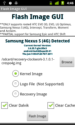

Screenshots:
Splash Screen
Main Screen
Options in Main Screen

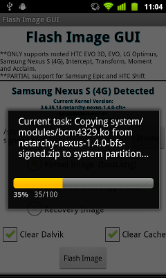

Flashing Netarchy Kernel with Progress Bar Details

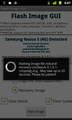

Flashing Clockworkmod Custom Recovery
