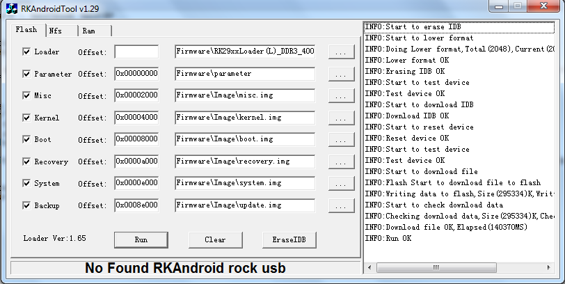

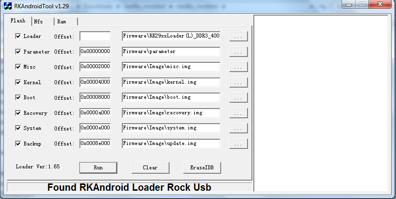

Step 7: Now you should be at the interface of the program and at the bottom in bold words it should say "FOUND RKAndroid rock usb" (if it doesn't then it mean the drivers probably weren't installed correctly). This part is VERY IMPORTANT!! Make sure all of the boxes on the left are checked (should look like the pic below). The one at top is the one usually missing a check and would need to be checked by you.

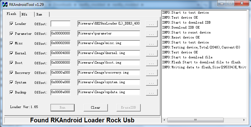

Step 8: Once all boxes on the left are checked you are going to click on "EraseIDB" at the bottom and let it complete. Once that finishes click on "Run" and you will see a series of commands running in the right window pane (see pics below). Give it some time as it will probably take a few minutes. When it's done it should look like the second pic below.
Once the process is finished your NEXTBOOK should reboot into the recovery and reflash the OS. Congratulations!!! You now have an affordable rooted tablet with access to the Android Market!!
