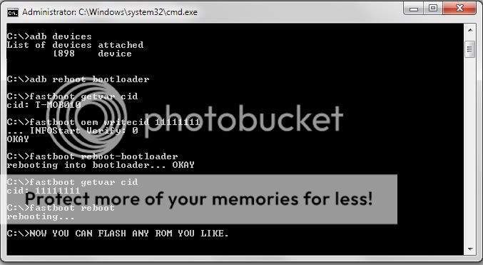

The process is very simple and exactly the same as the Sensation and most S-Off HTC devices:
1. Command prompt (or terminal for linux) and type "cd" "followed by the path to your adb folder" (windows users can type "cd C:\adb")
2. Ensure your phone is switched on (regular home screen) and connect it by USB in charging mode (Ensure usb debugging is on settings)
3. Enter the command "adb devices". This is to confirm your phone is connected. (It should come back with list of devices attached and your serial number)
4. Enter the command "adb reboot-bootloader". (nothing further required device WILL reboot in bootloader)
IF it doesn't you can Manually put the phone in the bootloader/hboot mode
Navigate to fastboot by pressing volume down and pressing power button to select (power off > vol down + power on)
It will take you to the fastboot bootloader screen on your phone
Connect your phone via USB
Your Screen should now read fastboot USB
5. Enter the command "fastboot oem writecid 11111111"
6. Enter the command "fastboot reboot-bootloader (Wait for it to reboot the bootloader)
7. Enter the command "fastboot getvar cid" [it should confirm your CID is 11111111]
8. Enter the command "fastboot reboot"
9. You can now flash any ROM you like.
To remove SuperCID and return to stock CID:
1. Follow steps 1-4 for SuperCID
2. Enter the command "fastboot oem writecid __________" <--- Here you will put either T-MOB010 (T-Mobile), TELUS001 (Telus), GLOBA001 (Wind Mobile Canada)
3. Enter the command "fastboot reboot-bootloader (Wait for it to reboot the bootloader)
4. Enter the command "fastboot getvar cid" [it should confirm your CID has changed]
5. Enter the command "fastboot reboot"
6. You are now back on stock CID (for your carrier)
