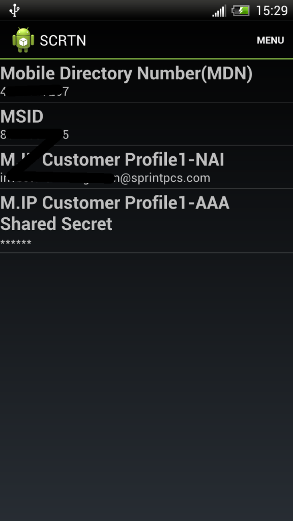

After entering the code, you are presented with a password prompt, which is where you input your MSL.
After doing so, you are at the SCRTN main menu.

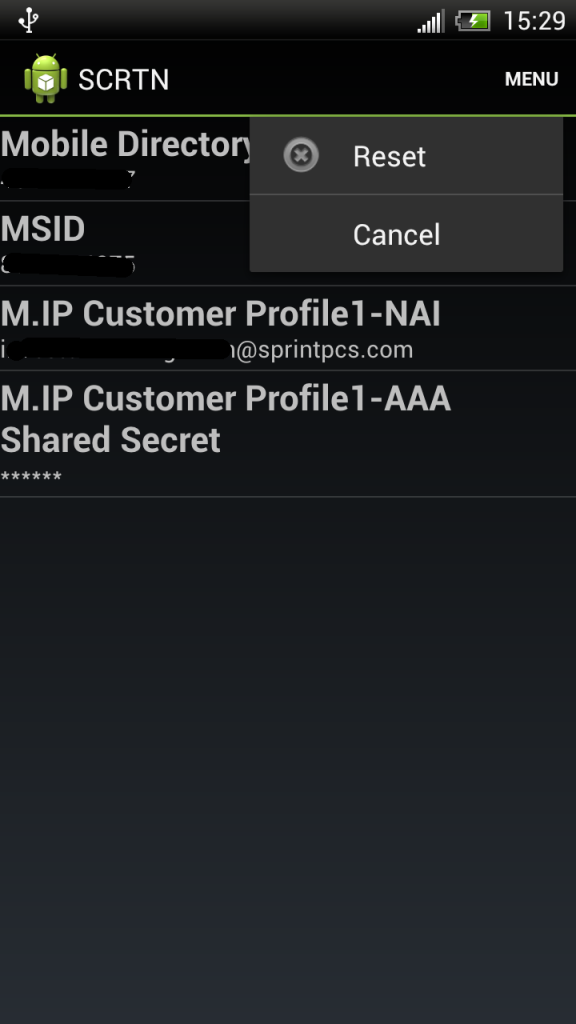

When you tap "Menu" in the upper right hand corner, one of the two options presented is "Reset".
Tap that bad boy and you get this confirmation message.
When you tap ok, it does it's thing and then reboots. When it finishes rebooting, it should start the handsfree activation process and then all will be right with the world....or at least it was for me.
