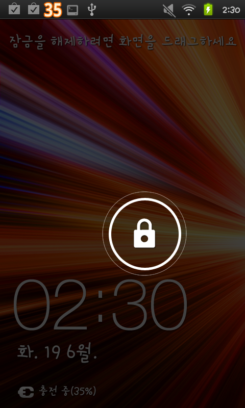

Post [Korean Model ONLY][GB1][ROM]KRKPL Port for YP-GB1 (+Superuser, Busybox)
이정도면 말이 필요 없겠죠?ㅎ
Do I have anything to say more? lol
SD카드든, 외장메모리든, 뭐든 다 정상 작동합니다.
SDcard, external sd, or anything from stock KRKPC work well.
상자님서버를 사용했습니다. 상자님 짱★
I used the server hosted by SANGJA. SANGJA good boy★
More explanation to foreigners.
In GB70, which is call the 5.0, has a latest firmware 'KRKPL' with the lock screen of Galaxy S2 ICS, and other devices' value pack upgrade.
But unfortunately, GB1 doesn't have one, so I'm here to port KRKPL to GB1.
The only bug was sdcard not mounting, so I fixed it easily. (It is kinda easy work for me lollollol)
Link
http://box-cloud.com:88/samsung/Gala...ovaKPLBase.tar
아;;카메라 오류를 생각못했네요. 얼른 픽스하겠습니다.
KOREAN MODEL YP-GB1 ONLY!!!!!!!!!!!!!!!!!!
I DON'T HAVE ANY RESPONSIBILITY FOR BRICK!!!!!!!!!!
