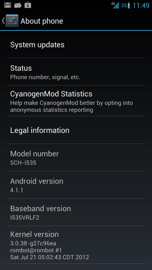

Just to let you know if you didn't already. CM10 (JellyBean) is working with k-exec on the SCH-I535.
Link to thread
http://forum.xda-developers.com/show....php?t=1783262
Big Thanks to beanstown106
This thread is for discussion on cm9/cm10 with k-exec. Please provide any issues or success stories.
It appears everything works so far... And it's the quickest rom I've ever used in my life!
Just follow instructions. Very easy.
This is what i did..
1. Copy the d2vzw_recovery.img, cm10 rom, and gapps to the root of the sd card (not the ext-sd card)
2. download and run terminal emulator from google play and run it
3. (This will install the k-exec compatible cwm recovery)
type the following commands
su
dd if=/sdcard/d2vzw_recovery.img of=/dev/block/mmcblk0p18 bs=256k
sync
reboot recovery
4. Make a backup of current stock rom using cwm recovery just in case something goes wrong or you dont like it.
5. Wipe data, cache, dalvic cache and install cm10 and gapps reboot.
6. You are now running Jelly Bean
It will bootloop the recovery once on every reboot. This is normal with k- exec
If you don;t like it, or there is a problem, simply reboot to recovery and wipe all. Then restore stock rom backup.

Have anyone run into the data problem like the one in CM9? Is camera/camcorder working? Thanks!
22nd July 2012, 07:01 AM |#6
incubus26jc's Avatar
OP Recognized Developer
Flag Illinois
Thanks Meter: 3,577
4g works like a charm for me. Also, Camera, front cam and video on both work just fine.

I'm running super on this! Why is this still a preview? Feels like a solid release to me lol.
