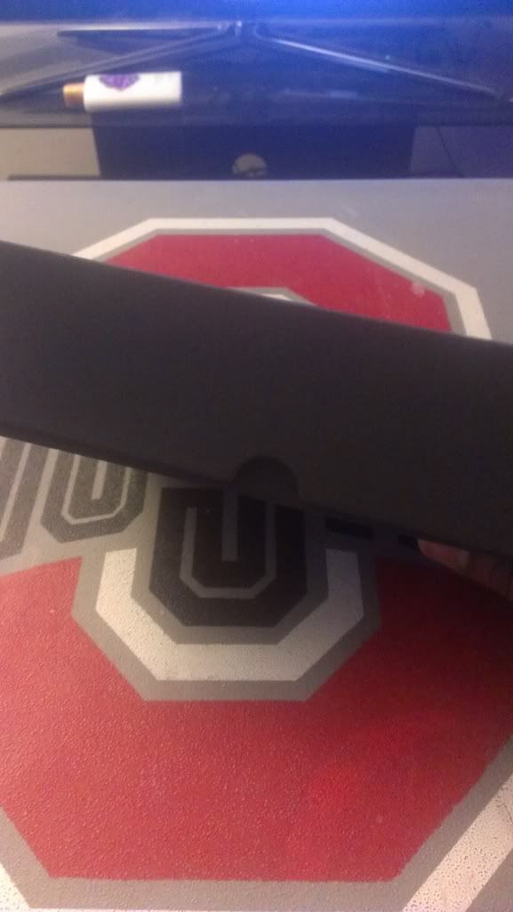

First up is the box. Im not sure when they made this change but my C70 didnt have the notches on the box for easy opening. I remember kinda having a hard time separating the box when I first got my C70.

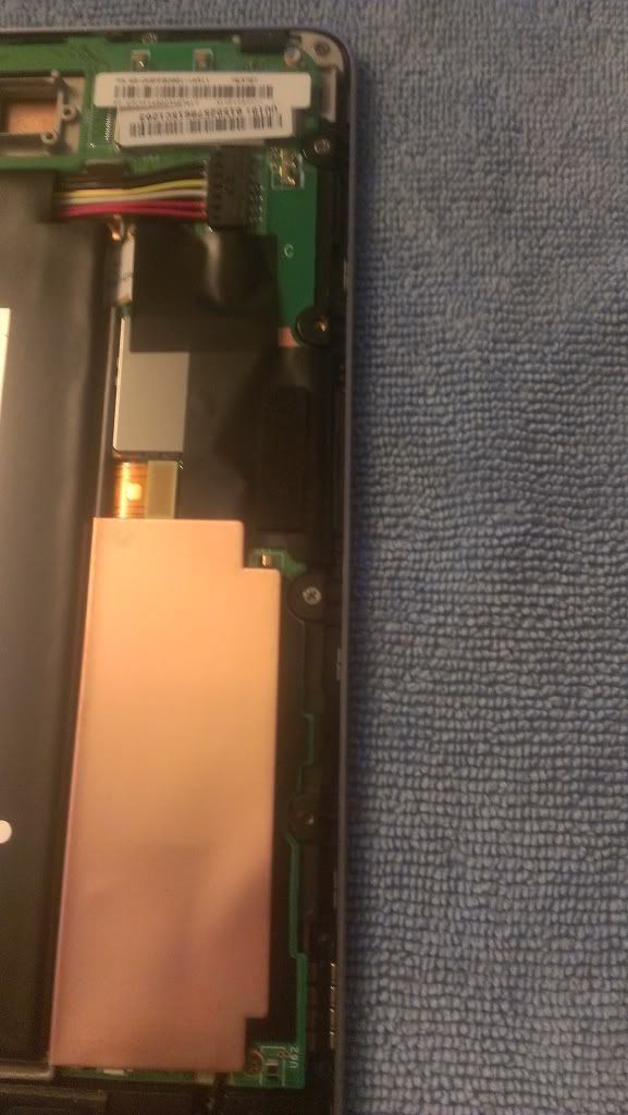

Second thing I noticed was the C80 units have a few screws missing. Im not sure if this is something they just started doing, but I exchanged three C80 units at Gamestop yesterday because me and the manager thought it was a flaw but all 3 random units had the two missing screws.

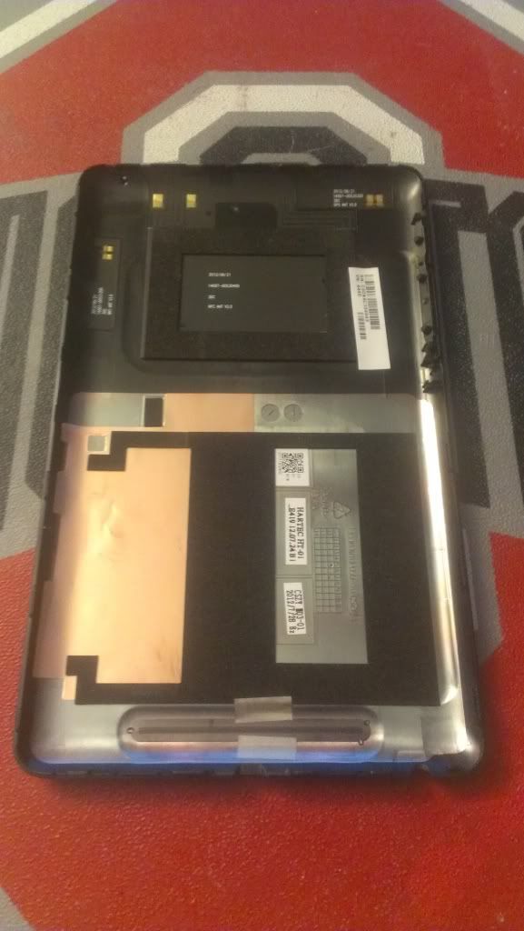

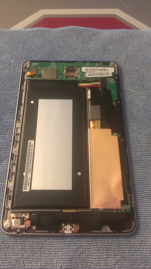

Here are a few shots of the back cover and unit. Im not sure if anything is different but maybe someone whos more familiar with the insides may notice something.

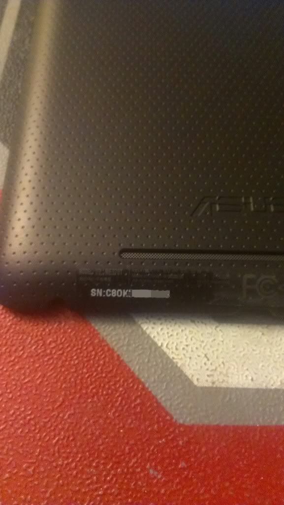

I did noticed the serial # on the rear sticker is now printed in white as opposed to black:

I removed those 2 screws on my C70 just now If the reason is in fact to reduce the stress on the screen to reduce cracking, then maybe it's recommended C60 and C70 owners to do this too?

I have just opened my tablet, it is the C80 version too. And there are missing the same screws as in your tablet.

Asus fix is remove screws!

Sweet! So I guess this was something done on purpose. I'll see if I can get a official word from Asus regarding this. It would be kinda funny if all the people returning earlier built tablets because of missing screws found out it was done like that intentionally lol.

I also have removed those screws on my C6O. The screen is not lifted now, and when i put pressure on the opposite corners of tablet, i don`t hear crackling.
I hope it will be pernament fix of this problem.
