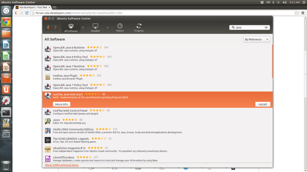

OK YOU READY. LET'S GET CRACKING. First you need to set up Java on your box. Then grab a couple of programs you will need for editing files Go to your UBUNTU SOFTWARE CENTER. In the search bar in the top right type in Java. We will be installing Java 6 Runtimes.
The Sun JDK is no longer in Ubuntu's main package repository. In order to download it, go here JAVA
If the link does not work, you want accept the license agreement and download jdk-6u35-linux-x64.bin

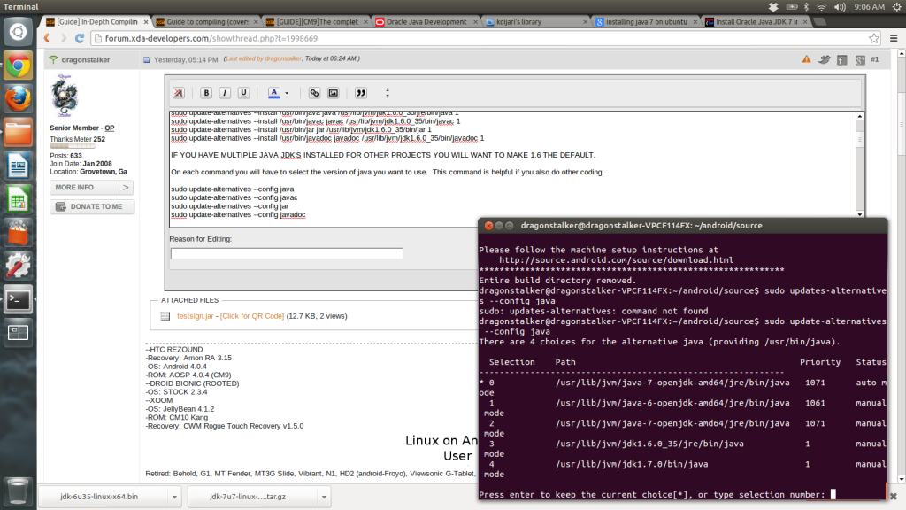

IF YOU HAVE MULTIPLE JAVA JDK'S INSTALLED FOR OTHER PROJECTS YOU WILL WANT TO MAKE 1.6 THE DEFAULT.
On each command you will have to select the version of java you want to use. This command is helpful if you also do other coding.
sudo update-alternatives --config java
sudo update-alternatives --config javac
sudo update-alternatives --config jar
sudo update-alternatives --config javadoc

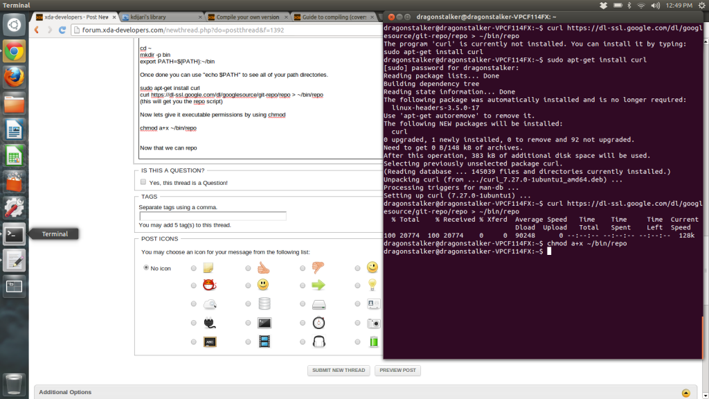

Now we need to tell the computer how to "REPO", this is where you will tell it to handle the Andorid sources via the Git command.
cd ~
mkdir -p bin
export PATH=${PATH}:~/bin
Once done you can use "echo $PATH" to see all of your path directories.
sudo apt-get install curl
curl https://dl-ssl.google.com/dl/googlesource/git-repo/repo > ~/bin/repo
(this will get you the repo script)
Now lets give it executable permissions by using chmod
chmod a+x ~/bin/repo

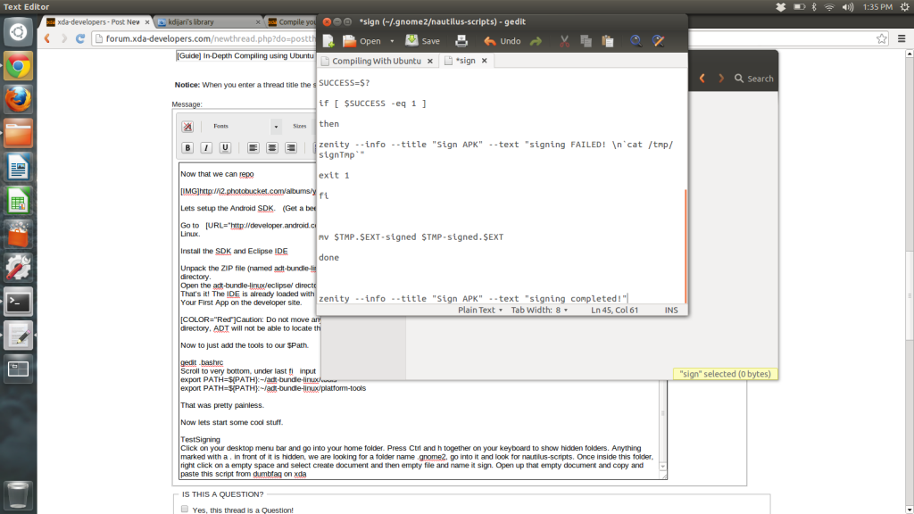

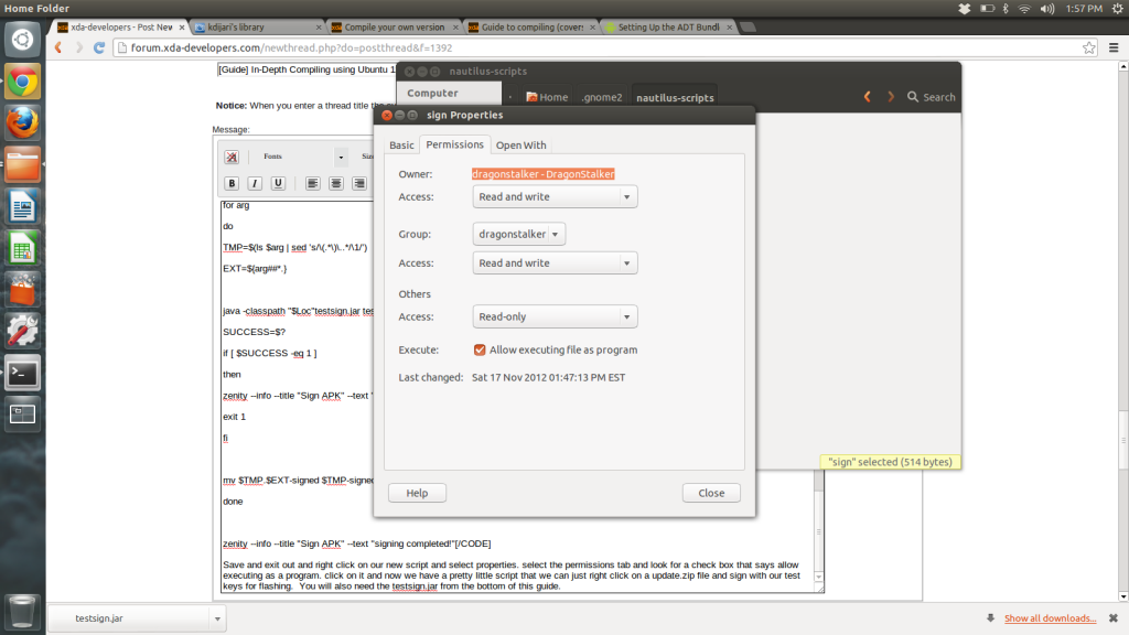

TestSigning
Click on your desktop menu bar and go into your home folder. Press Ctrl and h together on your keyboard to show hidden folders. Anything marked with a . in front of it is hidden, we are looking for a folder name .gnome2, go into it and look for nautilus-scripts. Once inside this folder, right click on a empty space and select create document and then empty file and name it sign. Open up that empty document and copy and paste this script from dumbfaq on xda
#!/bin/bash
# Update the Loc var to where YOU stored the testsign.jar file !
SUCCESS=
Loc=~/android/source/
for arg
do
TMP=$(ls $arg | sed 's/\(.*\)\..*/\1/')
EXT=${arg##*.}
java -classpath "$Loc"testsign.jar testsign "$arg" "$arg"-signed 2> /tmp/signTmp
SUCCESS=$?
if [ $SUCCESS -eq 1 ]
then
zenity --info --title "Sign APK" --text "signing FAILED! \n`cat /tmp/signTmp`"
exit 1
fi
mv $TMP.$EXT-signed $TMP-signed.$EXT
done
zenity --info --title "Sign APK" --text "signing completed!"
Save and exit out and right click on our new script and select properties. select the permissions tab and look for a check box that says allow executing as a program. click on it and now we have a pretty little script that we can just right click on a update.zip file and sign with our test keys for flashing. You will also need the testsign.jar from the bottom of this guide.

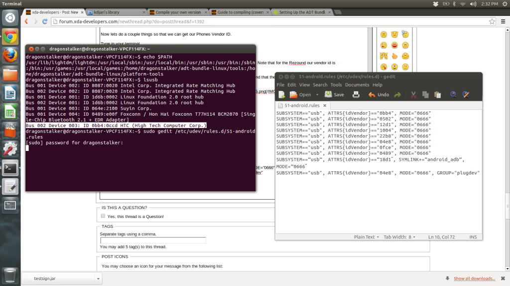

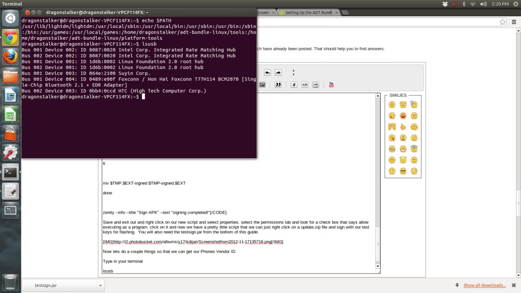

Now lets do a couple things so that we can get our Phones Vendor ID.
Type in your terminal
lsusb
While your phone isconnected to see our vendor id and you will something like this. Note that for the Rezound our vendor id is
Bus 002 Device 003: ID 0bb4:0ccd HTC (High Tech Computer Corp.)
In this case the Vendor Id is “18d1″ and the Product ID is “4e12″. Please keep in mind that the Vendor ID for HTC changed from “0bb4″ to “18d1″. The older HTC phones like the G1 have a Vendor ID of “0bb4″.
Now that we have that, we can make our rules for for connecting to adb
sudo gedit /etc/udev/rules.d/51-android.rules
Paste
SUBSYSTEM=="usb", ATTRS{idVendor}=="0bb4", MODE="0666"
SUBSYSTEM=="usb", ATTRS{idVendor}=="0502", MODE="0666"
SUBSYSTEM=="usb", ATTRS{idVendor}=="12d1", MODE="0666"
SUBSYSTEM=="usb", ATTRS{idVendor}=="1004", MODE="0666"
SUBSYSTEM=="usb", ATTRS{idVendor}=="22b8", MODE="0666"
SUBSYSTEM=="usb", ATTRS{idVendor}=="04e8", MODE="0666"
SUBSYSTEM=="usb", ATTRS{idVendor}=="0fce", MODE="0666"
SUBSYSTEM=="usb", ATTRS{idVendor}=="0489", MODE="0666"
SUBSYSTEM==”usb”, ATTRS{idVendor}==”18d1″, SYMLINK+=”android_adb”, MODE=”0666″
SUBSYSTEM=="usb", ATTRS{idVendor}=="04e8", MODE="0666", GROUP="plugdev"
Save and exit

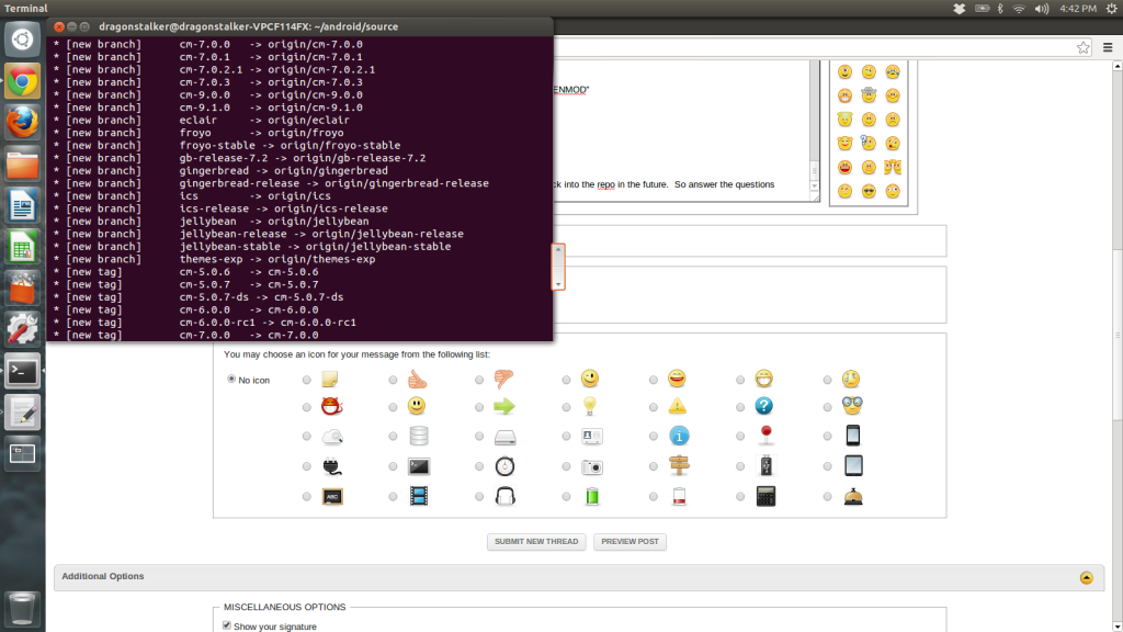

Now the MEAT AND POTATOES. Grabbing the Source. "CYANOGENMOD"
cd ~/
mkdir -p android/source
touch ~/.netrc
cd ~/android/source
sudo apt-get install git
sudo sysctl -w net.ipv4.tcp_window_scaling=0 (remvoes the overstack flow problem that causes some repo jobs to hang)

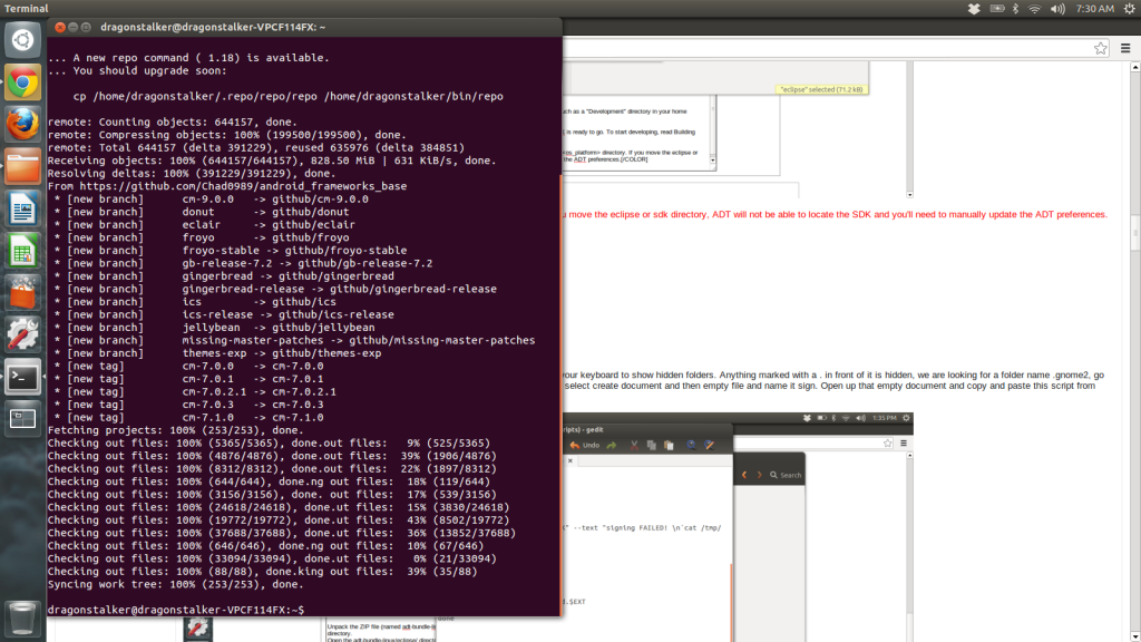

repo init -u git://github.com/Chad0989/android.git -b ics
(Note: If you want to compile a jellybean rom, just replace the ics with jellybean!)
Once you do this, it's going to ask you for your email. This is how you will log back into the repo in the future. So answer the questions correctly.
Now we will sync the Repo and set it to run.
repo sync -j4
-j# (# means twice the amount of cores in your computer) means jobs. I have an i7 processor and a pretty decent internet connection, so i'm running max jobs at once for faster sync) Be patient. It's still going to take a while to clone the directory.

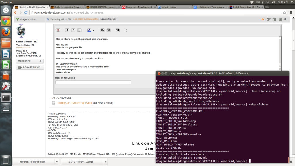

Once done with the Sync we want to setup our device.
This is where we get the pre-built part of our rom.
First we will
./vendor/cm/get-prebuilts
Probably all that will be left directly after the repo will be the Terminal service for android.
Now we are about ready to compile our Rom:
cd ~/android/source
repo sync (it should only take a moment this time)
. build/envsetup.sh
make clobber
Now you can compile your rom using the brunch command (This will take about 1 to 1 1/2 hours depending on your box)
brunch vigor
Now you can go to the output box and pick up your freshly made Rom.
