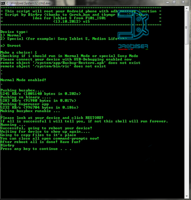

How To Root QMobile A10 Noir
First of all Lets start with the root process.
1. Download the following file.
Root_with_Restore_by_Bin4ry_v15.7z
2. Enable USB Debugging on your device to do that goto Settings>Development>USB Debugging
3. Connect your device to any laptop/PC and install drivers using PDANet
4. Unzip the root tool downloaded above.
5. Change the Mode of your device from USB Storage to Media Device to proceed further.
6. Run the Runme.bat file as shown below.
7. A command prompt with green letters will come up on your screen.
8. Follow the onscreen instructions carefully. To start off, you willl need to type in a "1" and press enter.
Note: If you ever want to Unroot your QMobile A10, follow the above steps till you reach this one and then, instead of typing "1", type "x" and hit enter. Follow the instructions that appear on the command prompt after that.
9. Your device will reboot during the process after which Bin4ry will copy some files to your device.
10. When the green letters in the command prompt says Have Fun!, then... Have fun.
That means, your device is rooted now and you can enjoy Superuser permissions!

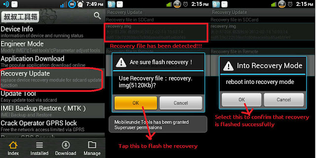

Install CWM Recovery on QMobile Noir A10
1. Download cwm recovery from the given link cwm_Recovery_QMobile_Noir_A10
2. Extract it, rename it to recovery.img & transfer it to the root of your SD Card.
3. Download and install MobileUncle MTK Tools from Google Play Store and run it.
4. Select the option recovery update from the application and when it ask for path guide it to the location where u copied the downloaded recovery file.
5. It will install and upon successfull installation it will ask you to reboot into recovery, select OK to go to newly insalled cwm recovery to confirm the installation.
6. If anything goes wrong you can download and install Stock Recovery For QMobile Noir A10 by using the above mentioned process again to revert back all the changes.

Your instructions are a bit wrong.
For this tool to work, the device needs to be detectable in ADB (you can check by typing 'adb devices' in command prompt).
If you follow STEP 5, this won't be possible and the rooting process won't be able to start.
Step 5 needs to be ignored. You need to put the device into USB Storage mode for this process to work.
