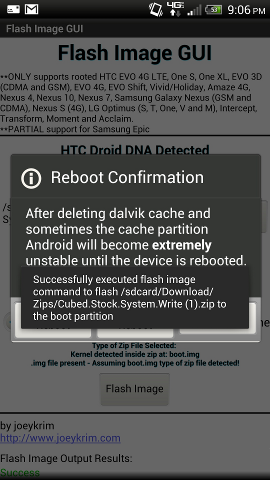

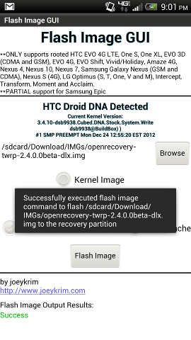

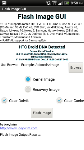

Screenshots:

5) Flash Image GUI will provide a warning, reminding that the ROM .zip file will *need* to be flashed in the custom recovery afterward.
