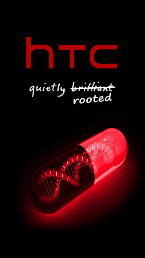

I want to cover the basics on this, and please don't be afraid to ask us ANY questions. This process is simple and direct and with little effort, you will have a custom splash screen of your liking.
REQUIREMENTS
OPTIONAL
PROCEDURE
  1. The first thing to do is find the Custom Splash Screen of your choice HERE
  2. We made it simple to tell what Custom Splash Screen goes with what .img files by matching them with the same filename and the .png files.
  3. Download the <filename>.img of choice, don't bother with the <filename>.png files, they are just for show.
  4. Once you have the <filename>.img downloaded to your computer, move the file to your working folder. (i.e Platform-Tools)
  5. Plug your USB cable and phone into the USB on your computer.
  6. Once plugged in, open a command prompt within your working folder and type the following command to make sure ADB is recognizing your phone:
    adb devices
  7. Once your device has been detected, type in this command to boot into Bootloader:
    adb reboot bootloader
  8. Once your on the Hboot/Bootloader screen type this command to flash your <filename>.img to your Droid DNA:
    • PLEASE keep in mind that <filename>.img represents the file name you downloaded.
    fastboot flash splash1 <filename>.img
  9. Once terminal is finished type this command to reboot or simply navigate down with your Volume down button to "Reboot" and press the Power Button to confirm.
    fastboot reboot
  10. Once reboot has started you will be able to see your Custom Splash Screen.
