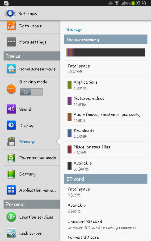

I used a 64 GB micro sd card. That became my internal storage (Sdcard0) while the original internal storage now shows up as (extSdcard) ( Which is approx 10GB ) so you can use it all but it will be 2 separate storage areas.
Just look at the OP's post, he has a pic of how your storage will be showing up.

64gb SanDisk Ultra. Yes u can.
Sent from my GT-N5100 using xda app-developers app
