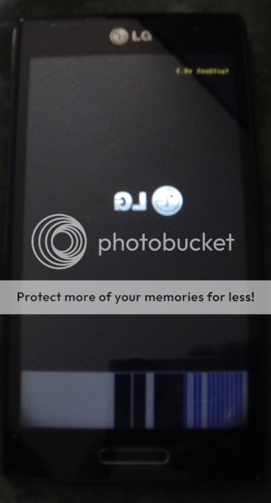

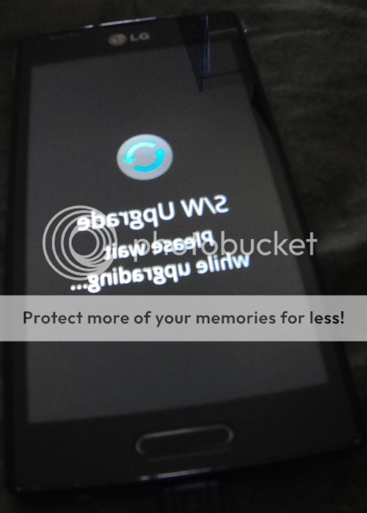

Does anyone know how to get it unbricked and back to "normal"? I'ved tried fastboot and that seems to be the only thing I can do with my phone. But all it does is go to a black screen with the lg logo and it's inverted. After doing this it turned my S/W upgrade mode inverted too! I did noticed that the logo in the S/W upgrade mode was green and now when it got inverted it turned blue. Maybe this was my imagination. I don't understand fastboot though because I can't do anything there, I press all buttons but nothing happens. I try fastboot from this tutorial http://forum.xda-developers.com/show....php?t=2119090 and when I get to step 14 I don't know what they mean by installing the drivers again. When I try to it just says they are up to date.

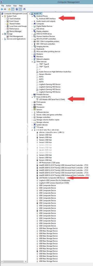

So can someone tell me in detail what to do? That way I don't spend too much time trying to figure out things because I'm short in time with work and school. Thank you and here a few pics of what my phone looks like the places where it appears on my computer.

What do you mean by select option 5 and then #1? When I'm in fastboot I can't do anything, its just the screen, no options show and nothing happens when I i press any buttons. I tried to do what you said and this what it looked like. When I go back to R&D the same thing keeps happening. It says there's problems communicating my phone with the pc.
This is how I fastboot it and how I did the fastboot erase cache like you said

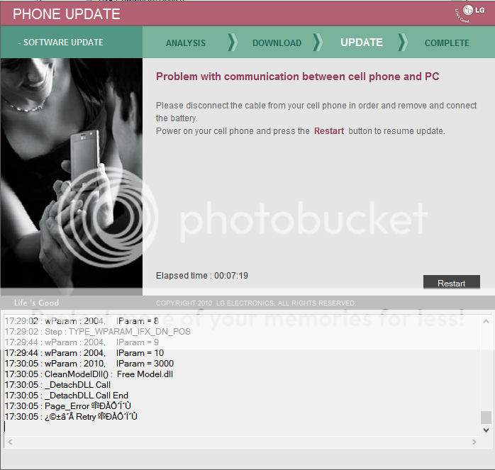

I used the new fastboot you said. Well this got my inverted s/w upgrade mode fixed. Now it is normal and the little s/w logo is back to green. When I try to do the phone update it stops once again at 15%. The first time I flashed the v20f I had this problem but instead of going straight to s/w mode to upgrade the phone I had to just connect the phone and put it in lg software mode. When I did this and ran the update it automatically set my phone in s/w upgrade mode. But since my screen is only stuck in s/w I guess that is why it is failing the update. When I do run the fastboot at the end it takes me to the "yours" folder. Is there any files i can download and put in the yours folder and run them through the fastboot to maybe get the phone unstuck in the s/w upgrade mode?

I put all those commands then tried to do it again. Now it stops right at the Analysis part saying that USB cable and my phone are not connected. Or something it gets all the way to the Update part and also stops at 15%. After I did those commands I went again to do the faboot option 5 then 1 and tried it again and the same thing keeps happening. I even tried doing option 7 because my phone came with jb already and still no luck. When it is updating the phone does shuts off("disconnects itself") and then turns itself back on. I don't know if that is normal.
On the R&D test tool. What should the work directory be? I changed it at one point, is it the same as where you have the kds file in? The first time I did this I had phone mode in emergency and then I see another video that says that phone with v20f should keep phone mode in DIAG.

Yup I even did it again to test it. In fastboot I pick option 5, then option 1 to erase cache and then when I run the R&D tool It passes through analysis and download just fine. When it reaches the update I notice that at 4-5% the phone turns itself off or disconnects itself and then it connects back and reaches all the way to 15% and after a little while being on 15% it says that there is no connection between my phone and computer, to reconnect it and press restart to resume update.
The Lg tool makes me choose the phone I got and I picked the metro pcs ms769 and downloads the drivers. I tried doing the tmobile p769 but they only have the t mobile p769bk and when I choose that one it says files not found when downloading. So i proceeded with the metro pcs ms769 once I connect my phone and its detected I go to options and upgrade recovery. It then automatically finds my IMEI number to start. Like on the R&D tool I get past analyzing pc settings and download even though the download takes about an hour. When I get to the update it stops around 4% after the time elapsed reached 3 and a half hours I just closed it.
