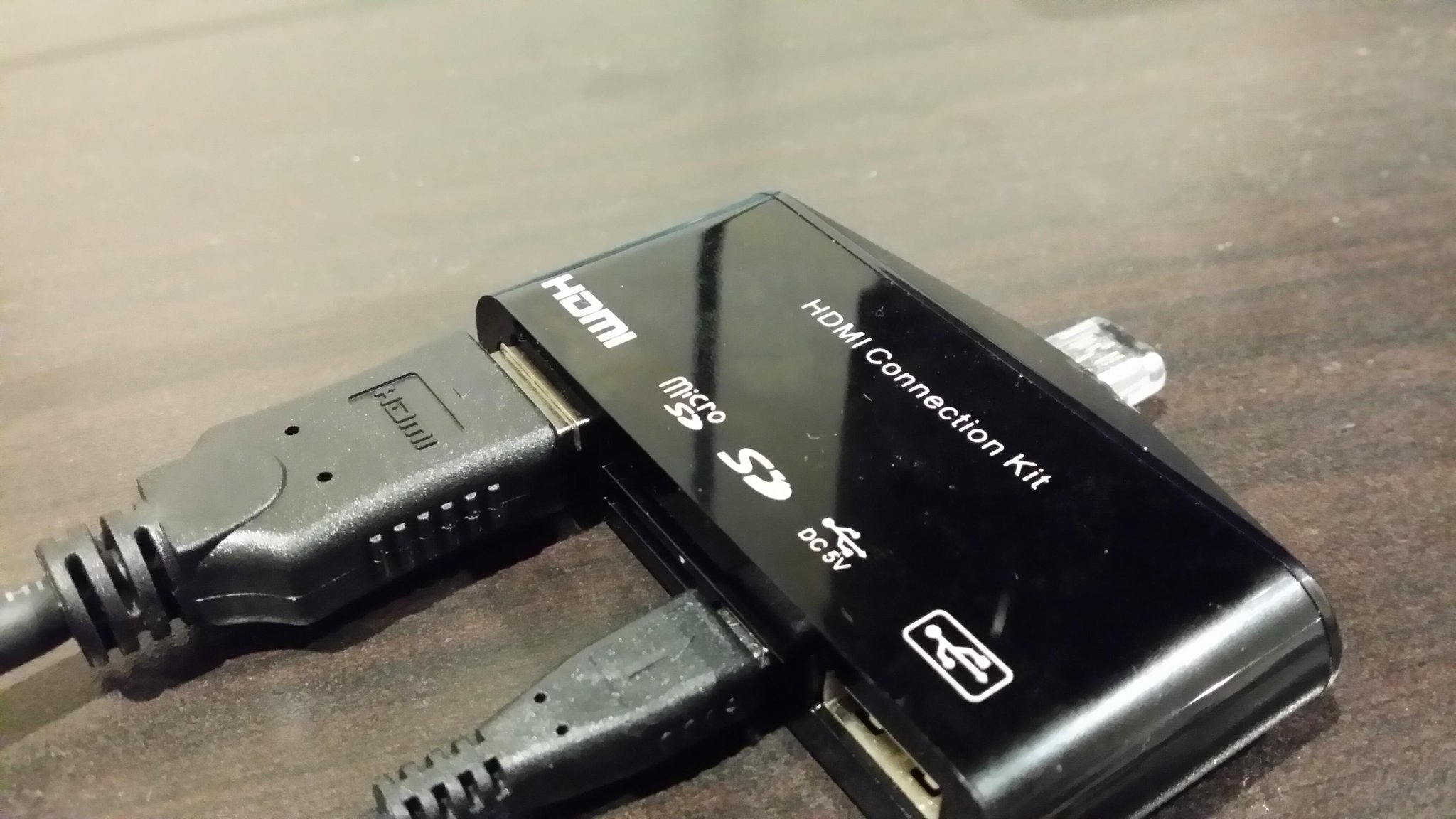

UPDATE:
This arrived for me this week, finally got around to testing it tonight and can confirm it works well, which is a great result for the $11USD it cost me from Ebay (including shipping). Considering it basically does everything the Samsung Smart Dock does I'm well pleased.
Few notes:
Yes, it is MHL 1.0 - I kind of expect them to revise these to MHL 2.0 before Samsung actually get around to releasing an updated dock.
USB OTG functions will not work without a 2A Samsung charger connected apparently, I was initially using a cheap charger that happened to be in the multi-board the TV was plugged into and was disappointed when nothing would work. Got of my lazy @$$ and grabbed my Samsung charger and all working. Plugged in my externally powered USB hub and then a Logitech K400 keyboard/mouse combo, card reader with a 16GB full-sized SD card in it and also a Logitech F710 controller. Happily watched some video from the card and then played some Dead Trigger 2 on the HDTV with the controller.
