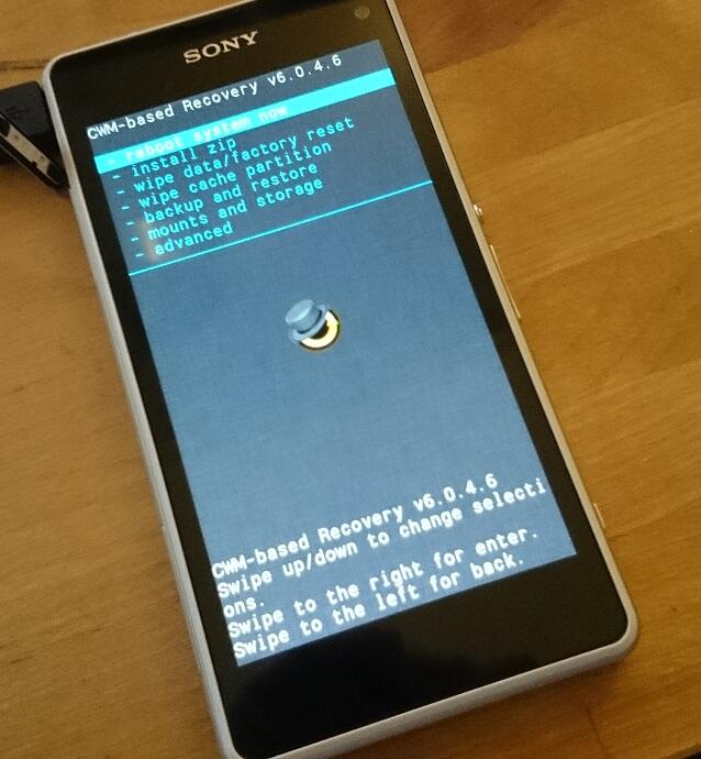

This is a CWM-Based Recovery 6.0.4.6 Touch Recovery for Xperia Z1 Compact!
Credits and special thanks to Koush and everyone else involved in Cyanogenmod project!
[ info ]
This Recovery is built from CWM 6.0.4.6 sources!
I dont have this device with me and I dont intend to buy one... my friend wanted root on his phone so I created this to help him out...
all the testing was done remotely on users devices...
[ PROOF ]
[ credits / special thanks ]
  • Koush - for the brilliant work & coding on CWM recovery
  • CyanogenMod and FreeXperia Team (especially jerpelea) for too many things *
  • special thanks to @swedan for helping out with testing and risking his devices for the sake of development!!! and NO, his phone was NOT damaged during testing
  • ME for creating this for u guys!

  1. standard CWM recovery 6.0.4.6 - TOUCH RECOVERY!
  2. kernel is insecure (ro.secure=0)
  3. adb debugging is enabled by default in OS

[ how to enter recovery ]
when you see the Sony logo and the LED light turns pink/amber/orange keep tapping/pressing VOLUME UP key
