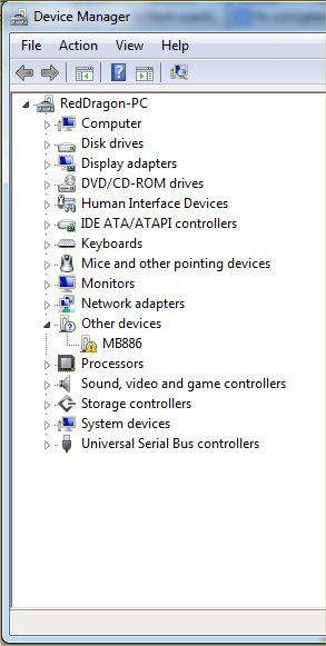

fastforward several hours later I now have philz touch 6 recovery which I read on this guide http://forum.xda-developers.com/show....php?t=2577447 you could use to fix the corrupted data partition. problem is when booted to philz recovery the driver for phone is not installed correctly.
The phone is recognized fine in fastboot mode however.

I never could get the phone recognized in recovery mode (philz mod) and using ADB as suggested by the guide I linked.
Finally what worked is I downloaded the stock rom zip, extracted it, edited the xml file in MS word deleting the 2 lines with "getvar" in them, booted the phone into fastboot mode, connected the phone to my PC and made sure it was recognized in device manager, loaded the xml from the stock rom into RSD Lite and flashed back to stock, rebooted, and all was working fine.
