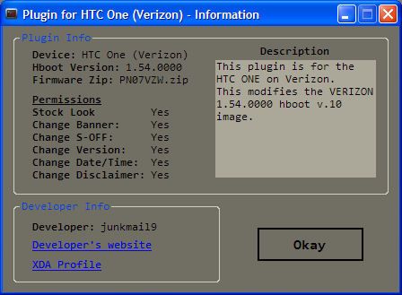

App Screenshot
Screenshot

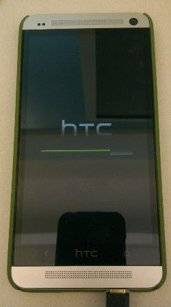

As noted in #4, the progress bar may not reach 100% when flashing this, and the the progress bar will likely look like this:
Just be sure to get the success response from the fastboot flash command and reboot via fastboot. Do not remove your phone from the computer until it has rebooted from the fastboot reboot command.

I keep getting error loading plugin even though i have it in the same folder as RegawMod. They are the only two files in that folder TBH. IDK what to do from here.
The Following User Says Thank You to jmotyka For This Useful Post: [ View ] Gift jmotyka Ad-Free
25th October 2013, 08:26 PM |#11
junkmail9's Avatar
Thanks Meter: 228
Make sure you have the latest main program. You will get an error loading plug in with earlier versions. If your main program is current and you have only one plug in, then the program will automatically load the single plugin in the same directory.
Also double check the md5 signature of the downloaded plugin.
Update: Main program needs to be version 2.2.3, not 2.2.2 as originally stated. Thanks to jmotyka for finding that. OP Updated accordingly.
