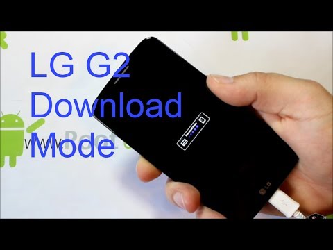

So i check several topics and i applied also download mod and back to stock (kdz uploader method)
For download mod it couldnt jump 2nd step stayed in like this
it couldnt go on 2nd step like this
when i plug usb cable pc didnt recognize as well (no plug-in sound for driver)
Can you help me pls. If I rescue my phone i will quit a long time for this kind of works i think

He just stated that he can go to download mode.
OP your issue is drivers. The phone is not connected to the pc. Try uninstalling and reinstalling drivers and see if that help

unfortunately pc connot recognize so i couldnt install drivers.
So what happened: recovery mod fail, download mod fail, boot fail, pc dont recognize phone
It was terrible but this topic save my life
http://forum.xda-developers.com/show...php?p=51123570
I lost my root but got back my phone. The issue is when i got twrp i install flashable rom which was in my internal storage if dont i cannot alive.
