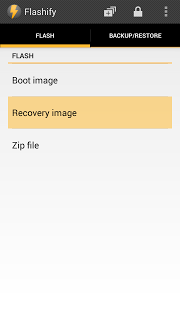

Method 2 :
This method is easy ..
1. Download the " Recovery.img " and " Flashify app " file from the links section above .
2. Copy the Recovery.img file to your SD card , and Install Flashify app .
3. Run the app .
4. Grant Superuser permissions if it asks ..
5. Take a backup of the existing recovery using Backup/Restore section in the Flashify app.
6. Select the Recovery Image option in the app under Flash section .
7. Locate the Recovery.img file on the SD card and select it.
8. Wait for process to complete.
9. Have fun with the SuperDevs Team Custom Recovery For Nokia X .
