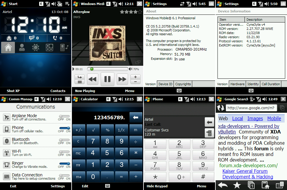

~ ONYX ~
Windows Mobile 6.1 & 6.5 ROMs
(For Elf and Elfin - HTC Touch GSM only)
WM 6.5.x version: CE OS 5.2.23134 (Build 23134.5.3.9)
WM 6.5 version: CE OS 5.2.21889 (Build 21889.5.0.87)
WM 6.1 version: CE OS 5.2.21057 (Build 21057.1.6.10)
Click on image to zoom
Onyx with Windows Mobile 6.1 (above) ...
A version of Onyx without the Manila 2D interface is also available!
... and with Windows Mobile 6.5.x and 6.5 (below)

Default Onyx FAQ (Part 1 of 2)
Frequently Asked Questions (FAQ) - Part 1 of 2
Part 2 of FAQ is here (it's the next post in this thread)
First Time Users (Newbs)
Q. To what device can I flash Onyx?
A. This forum and this ROM are for GSM (SIM card) versions of HTC's 2007 Touch (Elf/Elfin) only. Please use common sense -- it's NOT for Vogue/Diamond/Cruise/HD/Omnia/Viva etc.
Q. I'm new... How do I install Onyx?
A. Follow these steps:
  1. Optional: Find your device's CID and Device ID
  2. Optional: Make a backup of the stock ROM currently on your phone. If you have saved a shipped ROM that matches your CID and Device ID, then you can skip this.
  3. Install an IPL/USPL or HardSPL which removes the CID lock on your phone. HardSPL 3.10 and IPL 3.10 are recommended. (NOTE: HardSPL 3.14 causes increased battery drain!)
  4. Flash Onyx when the above steps have been completed
  5. After the ROM is flashed, and you completed the screen calibration, allow the Customization to start and finish. DO NOT reset the device during customization, because it performs necessary configurations for the ROM.
Ask about CID unlocking questions in another thread, not here... Or read the stickies at the top of the forum.
